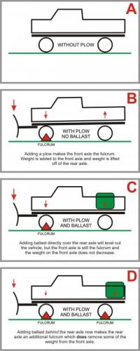

I disagree that the ballast wouldn't change the sag, because if you put enough weight in the rear it's definitely going to pull weight off the front end and free that capacity up for the plow.

Cool. I've run my truck across the scale with a trailer that put about 700 pounds tongue weight on the truck. It took about 250 pounds off the front axle in the process. Option D is what I'm doing, although my weight is probably a little too spread out to have maximum effect because it's on a pallet.
