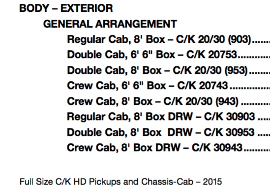

there are actually 3 different FAWR depending on options. here is the chart:
click here
looks like max plow weight for your truck should be 725 lbs
