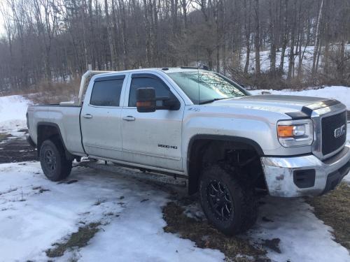

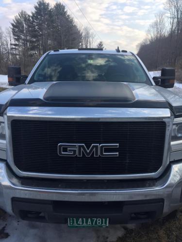

Finally got my lift on, and new shoes! (well work boots really, lol).
Using Readylift kit 69-3512 SST lift kit I got 3" up front and 2" higher in back, with tires another 1" so 4" total...Im very happy! Rides like factory, even came with shocks. Tires are 295/70 R18 Ridge Grappler.
I used 1-1/2" spacers to avoid trimming/rubbing. AND I love the setup sticking out a little, now I can install the Bushwacker extend-a-fender flares I wanted. More pics to follow!

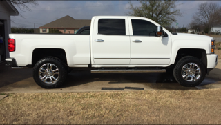

I like the grill I have the same one!! And I have the rough country 3.5 inch lift. Those tires are 285/70/17 but my summer set up are 20 inch and just ordered 35x12.5x20 so I'll post a pic after they are on!
Sorry , here is pic

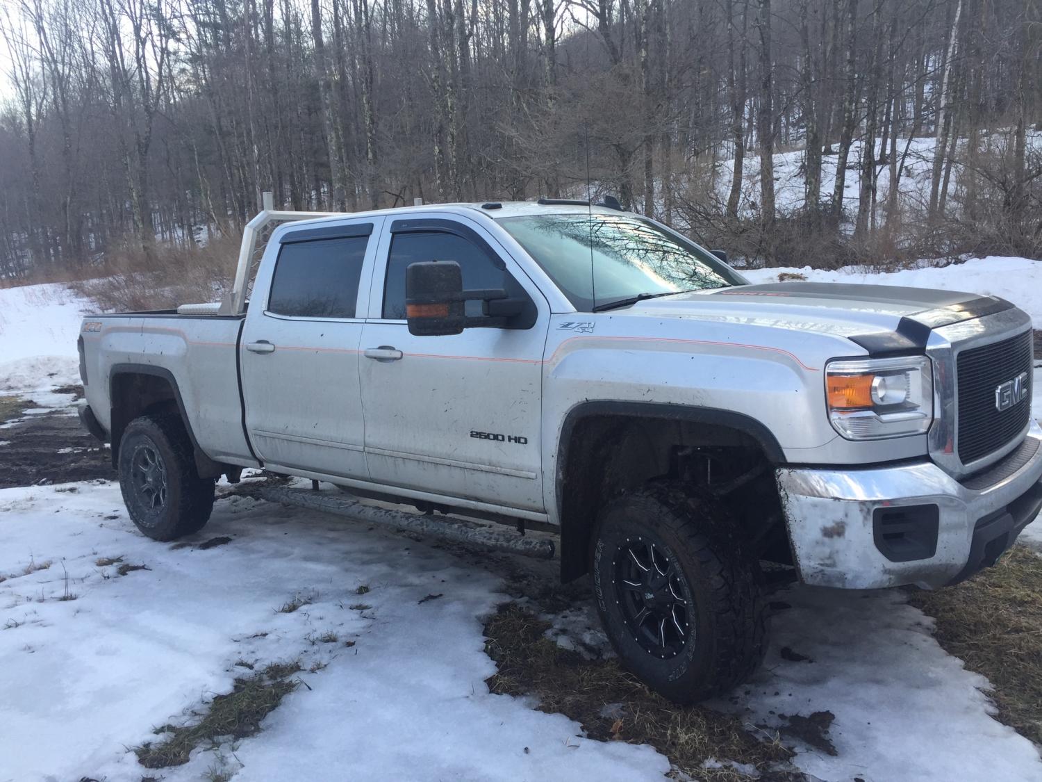

Looks good, have any pics from the side?
Back sticks out about 1-1/2" and front about 1". I have the Bushwacker "Extend-a-fender" fender flares being painted at my dealer, once installed i will re-post.
NO rubbing, plenty of room to go lock to lock. Rides stock if not better, tires psi at 70. Shocks i used came with the kit and kept ride great for road use, have not tried off road yet.
