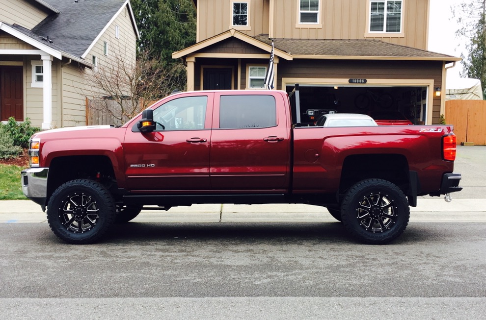

Had my leveling kit taken off, and a Rancho 4" installed! Rides like a factory truck, couldn't be happier. Selling my 295/60/20's (34x11.5's) Toyo AT's and buying 35x12.5 RT's. That extra 1" of tire makes a huge visual difference! Will post pics after the new tires are on. Actually I don't mind the way it looks with the 295's.

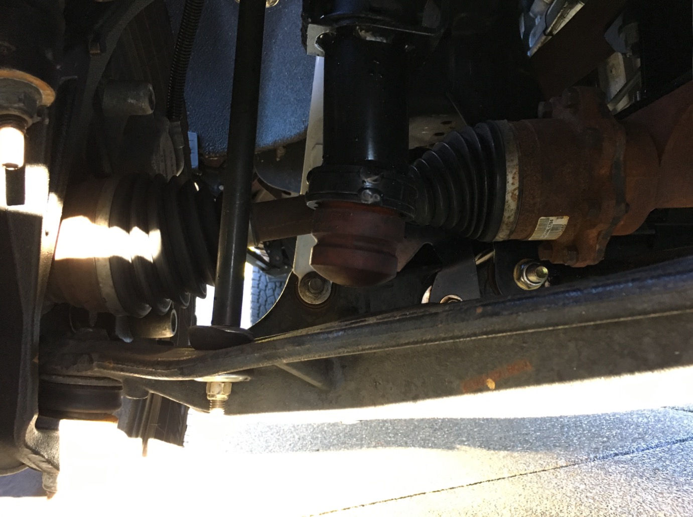

C/V angles aren't completely straight, they're a bit more angled but not bad at all. None of the ribs are touching. The drop down kits like Rancho really help keep a close-to-stock geometry. Rides really really nice.
Did some final measurements for anyone that is considering this lift:
Top of cab (not including shark antenna): 82.75"
Bed rail height (at rear wheel): 62"
Top of tire to bottom of fender F&R (I'm on 35's): 13"
What leveling kit did you have on with the 295/60/20s?? I'm looking to get those exact size tires and was wondering if you had any rubbing issues?
