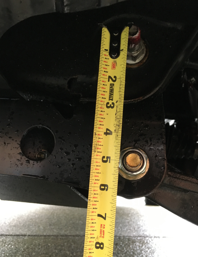

If you don't mind, I think a good indicator of the actual lift of this would be to measure the difference between the two bolt holes for the lower control arms on the drop crossmember

Snapped a couple pics under there. Hope this shows what you were kind of looking for. The distance between bolts on the drop down bracket. 5"

Definitely a 5" lift
