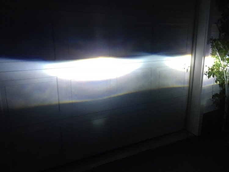

Well, I put them in the other day, and so far they are an 8mprovemnt over factory. They start out blue and turn to a very nice white.   They are definitely brighter, but I’m not sure they project that much further than stocks in high beam. Perhaps a little further, but not earth shattering. I’d say, as others have, the design of the projector might be the limiting factor no matter what the wattage. The box actually states they use Phillips parts in their bulbs, so they might be fine. For what I paid, I’m happy with them.  This isn’t a good pic, but it gives you an idea of startup color.  Keep in mind, my driveway is very steep and that forces the truck to point up.  One other tidbit....the headlights now match the fogs pretty closely if that matters to anyone.

Did you get the ballasts too?  Mine are bright enough that I don't know if I need brights anymore.  I raised the dims to shine out a bit farther and they go a long ways out.  I do notice the brights don't extend much farther than the dims.  These lights don't focus to a pinpoint spot 40 yards down the road like typical headlights.  They basically cast out a light and cover most of the area.  That is the hard part to get used to.  Clicking to high beams does not add anymore light, it just raises the lamp shade and exposes more bulb, and I think that is a hard concept for the eye and brain to accept.  I am still impressed with the dim lighting.   Before I put the Distant Extremes with ballast in, the dims were absolutely horrid.  I feel they are excellent right now.  Since I raised the dims to shine down the road, these put out great lighting.  Maybe I got a good set.  When I go up a hill, these lights blast clear out.  I feel funny driving through the neighborhood, going up a hill and having the dims lighting up a house three blocks away.
