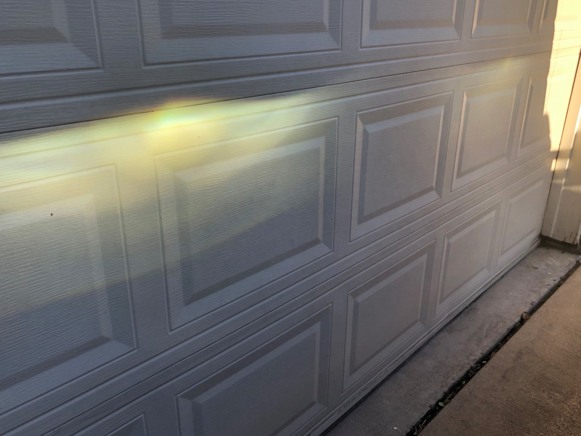

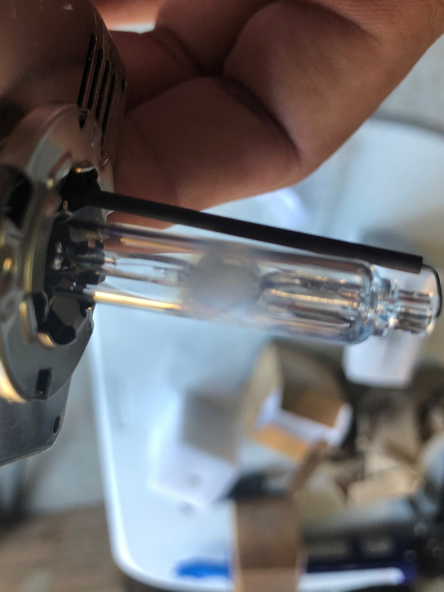

I finally installed the DAMA D5S lights I ordered and I have to say that I am quite happy with them.  Could be because they are new, but the light is a nice solid white color.  They are brighter than the Morimoto ones I had in before, but I think something happened to the Morimotos because in the center part of the bulb (trying to describe as best I can) it looks like the little chamber inside is burned.  The output as they are right now compared to the new DAMA's was almost nothing, but I think it's because of this situation with the bulbs.  This cannot be normal, or it it?  The Morimotos were in the truck for 13 months....
Pic 1 is one of the Morimoto light.  Pic 2 is DAMA light on the drivers side, Morimoto on the right during the day.  Pic 3 is both DAMA lights in at night.  It's totally reflecting off the garage door so it looks like it's glaring, but on the road it's nice and solid with decent throw.
I heard back from the site I ordered the Morimoto lights from.  That is not normal and I am getting them replaced under warranty.  I'm glad Morimoto stands behind their product.
