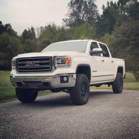

Tires are here. Going to try for install tomorrow morning. Just hopeful it's not so bad I can't drive it home..lol
That looks awesome! Did you have any rubbing?
Thanks!
It rubs a tiny bit in full lock reverse, but that's it.
My last Silverado had 305 20's and it rubbed way worse.
I really like this set up.
