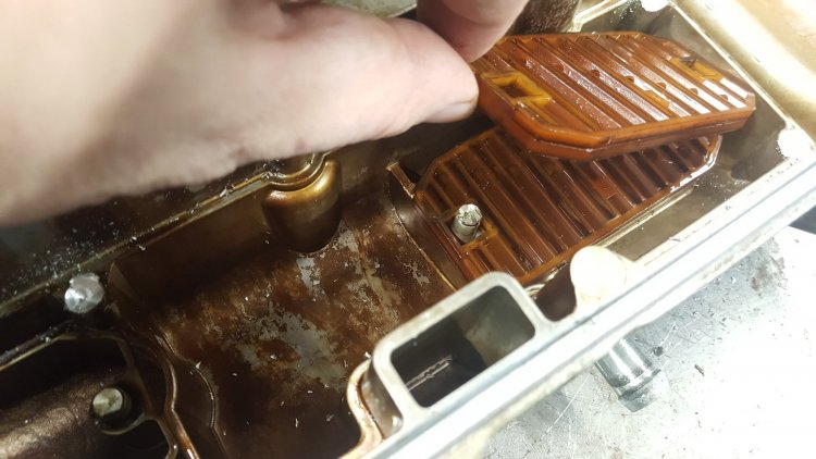

Valve cover baffle PCV baffle is riveted in.
Rivets drilled out
Fresh air side baffle exposed
Not really cleanable.
Edited by Grumpy Bear

6 minutes ago, Grumpy Bear said:
Do you think that the vent baffling is damaged or restricted in some way? If restricted by shellac or sludgy deposits  IF the blow-by and vent gases have the Cummins RESTORE in the flow that chemistry will clean it up.  If its damaged mechanically then nothing but repair will correct.
 Thats quite an extensive vent system.
I reloaded that post to rid it of the links.
Damaged? No I don't think so. Dirty? Yes. Plugged? No. Short ramble.
Between very long legged gearing and cam phasing, both to reduce pumping losses the manifold vacuum runs near atmospheric and as it is orificed and not valved flow goes both ways driving moisture into the fresh air side. Carries moisture into the air box trap where it freezes and the result is blown seals. Been there, done this. Cold weather is not her friend.
Running in M5 greatly increased the manifold vacuum and the moisture is greatly reduced. Hum....
I've been following a fellow who has installed a proper PCV which is really quite simple, for about a year. He routed it via a catch can. Which may make sense IF the baffling does not support the valve. I wanted to know exactly what was under there so I went fishing and caught the days limit. 😉 Eliminating backflow to prevent the freezing and increasing volume is the goal.
