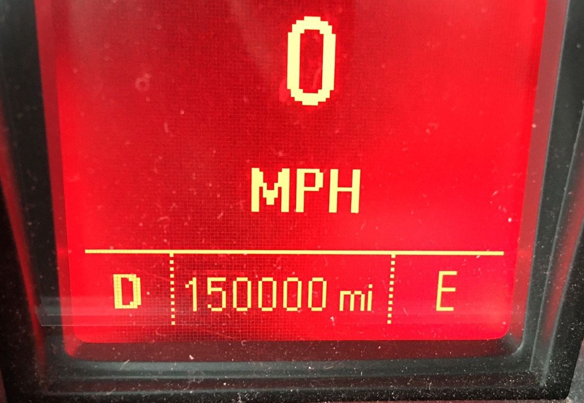

150,000 Mile Services
10/3/2021
149,877 Actual
2,367 miles this OCI
4.5 Quarts Kirkland 5W30
.125 quarts Royal Purple (what I had on hand to make up the shortage)
0.375 Quarts TRIAX S7 (13.3:1)
1 Purolator Pure One PL15436 Filter
20 ounce of make up oil. 8 I added and it was 12 short of full measured.
That's a quart in 3,442 miles
