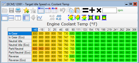

ic3man5 Posted April 14, 2018 Posted April 14, 2018 This was my fix: before: After: The truck runs at 212F usually fully warmed up so in gear its commanding 500RPM which is too low IMO. 660 made it go away.
2017Z Posted April 14, 2018 Posted April 14, 2018 Sorry but what am I looking at? Is this from a tuner and your readout? How did you get this view? ive thought about the tuner and ticking up idle sorry not familiar with what you posted.

ic3man5 Posted April 18, 2018 Posted April 18, 2018 On 4/14/2018 at 8:57 AM, 2017Z said: Sorry but what am I looking at? Is this from a tuner and your readout? How did you get this view? ive thought about the tuner and ticking up idle sorry not familiar with what you posted. Its a screenshot from tuning software (HP Tuners to be specific). The row In Gear is the one you should look at the most, depending on engine coolant temperature the ECU changes the idle speeds.

2017Z Posted September 18, 2018 Posted September 18, 2018 I had the engine mounts replaced and it did nothing. My solution was a diablo intune. You can adjust the idle up 50 rpm at a time. It’s almost not noticeable now. Past the rough idle the tuner is freaking amazing. I thought I’d be returning it because did not believe the tuner could really do what everyone says it does with boost and gains. I was dead wrong. Truck is so much fun to drive. It has corrected all the complaints I had with lagging downshift or whimppy shifting. I’m a believer now. Ive done both the 91 diablo tune and their CAI jammer tune (I have a kn). Both are awesome and not sure which I like better. On both I adjusted the idle and the shift firmness and truck drives crazy good. I think the rough idle is mostly that it’s set to low for fuel standards and tuner can adjust. Interesting thing is, using the tuner actually got me better MPG! best of luck
