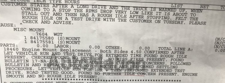

Mine was verified with the picoscope and exact issue described in the TSB. Still does it like nothing has changed. Any suggestions. Don’t know how it fixed it for 80%of trucks but mines the exception.
Rough idle in drive or all the time? Do you have a copy of your invoice that shows the technician notes. I’d love to see them.
Drive, after the engine is warm. Idle sets at about 500-490ish and shakes. Sometimes coming to a stop it vibrates so bad snd the idle drops to about 300 for about 2 second and feels like it will did. Exactly like the TSB. Cold starts when idle is at 6-700 it’s smooth as silk.
here is the copy of the work order listing the parts they used. It did not correct anything.
I have alsi tried CRC intake cleaner as others have suggested. Nothing.
I’m going to assume you have no other issues present, no check engine light, no tuning done, etc....
Also, what’s your particular engine, trans setup? When it’s rough idling, does it have a random stumble during that time or is it rhythmic?
Correct. No other issues. Just this. I have a kn CAI and CORSA exhaust but the rough idle was there before I installed those. No tune
Not sure what you mean by stumble unless your referring to the inter it’s the shake during rough idle. My kids call it the butt massage and wife says it feels like to going to stall.
5.3 with 6 speed. The ones everyone seems to complain about. I had a 2014 4.3 with 6 speed prior and never had this rough idle
So it’s there whether it’s in drive or not and it does it all the time or only when the engine is cold or warm?
I’m thinking your mounts are actually contacting the frame on the most inward bolts. I’d try to have the mount shimmer on the inside 2 bolts closest to the engine. A couple washers should do. Try this an give us an update. I’ve only had to shim a select few.
