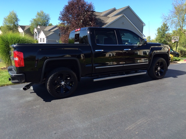

I have the stock 20" rims and stock size tires on my 15 Denali, I also have GM 22" rims and tires. The are the same height and circumference. But different side wall ratios, same size widths
