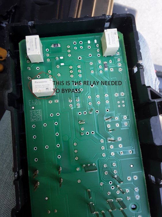

1767721077_20200201_1416191.thumb.jpg.798a13f074bebadb5e62a91c017b06fc.jpgTHIS IS THE RELAY THAT CONTROLS THE CARGO LIGHTS ON MY 2015 GMC SIERRA SLE , IM GUESSING ALL MODELS ARE SIMILAR . I JUST NEED TO CUT THE WIRE THAT COMES FROM THE COMPUTER AND FIND ONE THAT RUNS POWER TO THE  CARGO LIGHT SWITCH (BROWN WIRE /WHITE STRIPE) IS PIN #7 ON THE BACK OF SWITCH.
ALSO THIS CIRCUIT BOARD IS BEHIND THE FUSE BOX ON THE RIGHT SIDE(PASSENGER DOOR) , BROW/WHITE WIRE IS THE ONE THE CUTS POWER TO RELAY.
