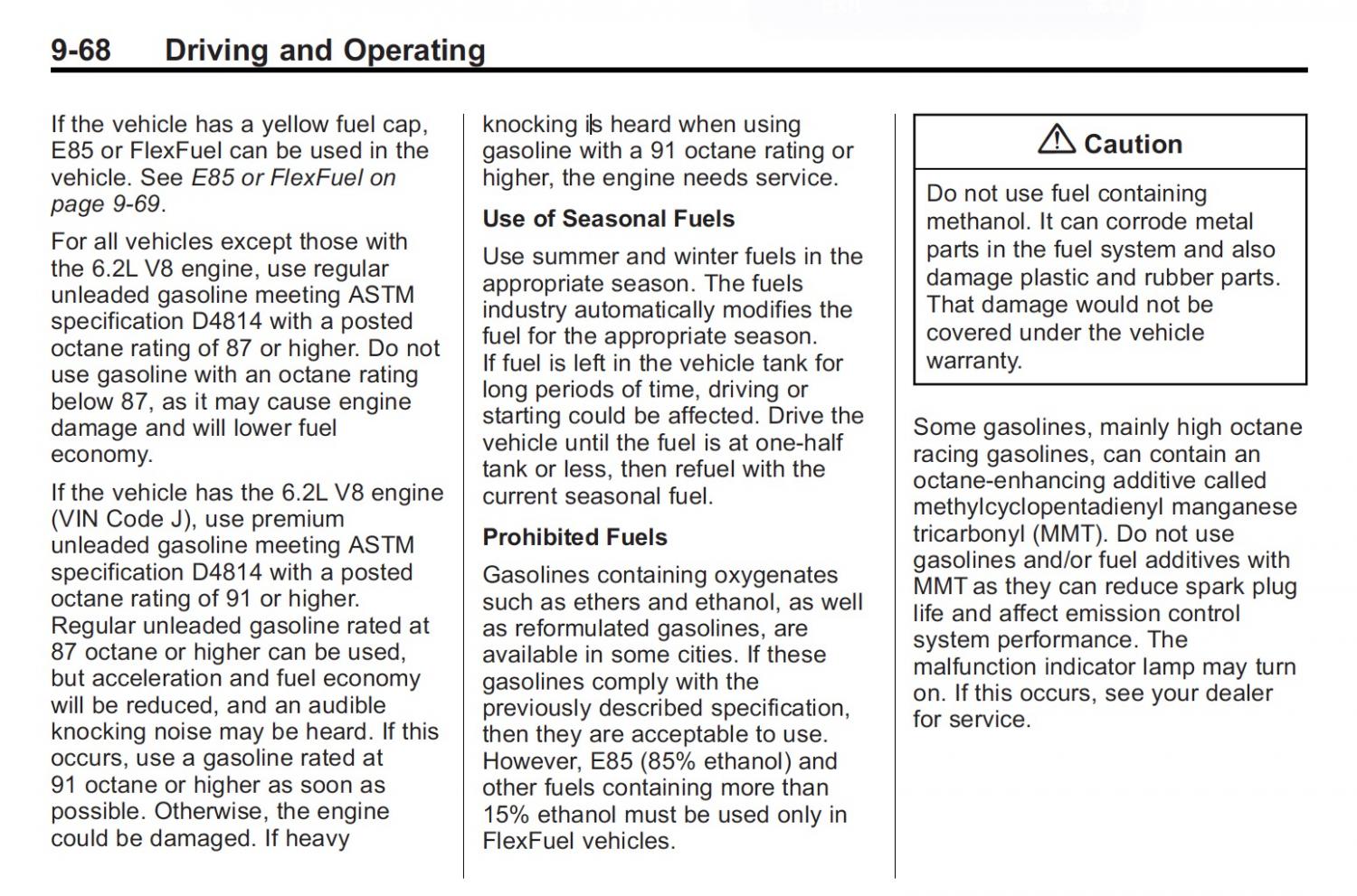

From what I recall/ my truck is at the dealership for repairs so I can't check right now right now, it was regular unleaded for the 5.3 and IF I remember correctly if not please correct me if I'm wrong, the 6.2l was premium. That's the little I remember from my owners manual. When I purchased the truck I forgot to ask the sales person what octane level to use on my new truck. I checked on the owners Manual and I recall regula for the 5.3 but I will check and have no issue admitting I'm wrong on what I recalled from the book

I think I might be wrong. I'm sure you and I have the same manual, if the book states that 87 OR higher then that part flew over my head because the key word I looked at and remember was regular unleaded and to me means the cheap stuff 87 lol! Now I know I can also use mid grade or premium if I like.
So this engine wouldn't work for what I was trying to get at, let's say a engine/ the owners Manual states regular only 87 period then using premium wouldn't be beneficial to the engine and a waste of money due to the fact it's tuned and designe to run on regular 87 and ours is designed to run on all 3! Learn something new about my truck!
Find, if one can, a reference that the engine as it comes from the factory to use regular 87 will take advantage of higher octane fuel from this part of my owners manual. It does say 87 or higher, but nothing about that it will take advantage of higher octane. It does say to not use less than 87. Only the 6.2 has a reference to premium, but regular can be used but switch to premium when available. This idea that GM just says to use 87 so they could sell more vehicles and the engine (non 6.2 variety) really can take advantage of higher octane sounds more like internet folklore.
