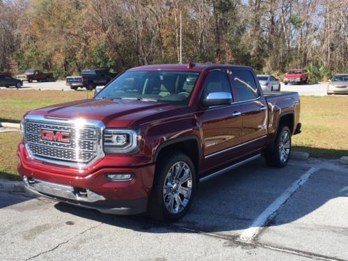

I previously owned a '11 Sierra SLT, then went to an '08 F250 and now back to my Sierra with a '17 Crimson Red Denali Ultimate. I've already installed window deflectors, Truxedo tonneau cover, Borla exhaust arriving today and in the near future about a 4" lift.
