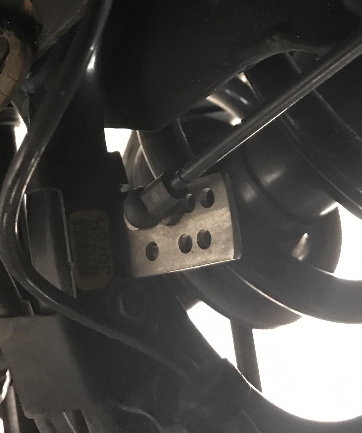

I've often wondered if there was a way to adjust the arm so that shock provides a bit more dampening effect. All the arm is doing is adjusting a potentiometer that engages the electromagnets that act on the fluid in the shock. The stronger the field they create, the more viscous the fluid, and the stiffer the ride. If the arm could be positioned in such a way to not generate such a strong field, then maybe some of the bed jumping I get on concrete highways around here could be lessened.

Thanks for all the posts...come to find out the dealership has said that there is a problem (which said there wasn't before) and are now looking to fabricate the bracket that comes with the Suspension Maxx kit. Apparently that one is the best because the bracket connects to the magnetic ride to let it know that it's extended further therefore the ride shocks need to extend with it. There is only one shop in Fort Worth that carries that brand and as soon as I walked in and told him my issues he knew exactly. Now we will see how my dealership handles it. I told them to just take mine off, refund me, and let me go over to this other place and have them install it. They said they can fabricate this bracket so I'll give them a shot...I'm not out of the woods yet, but we will see.
