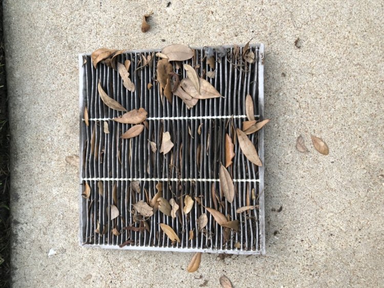

Just replaced mine today on my ‘17 AT and the same thing happened. Thanks for all the insight and it doesn’t surprise me one bit that I got some debris in the blower. I’ll be working on cleaning it out tomorrow I guess ??‍♂️

Holy crap, did you buy the one from the dealer that they keep and show everyone telling them that it is theirs?
That is a lot of stuff going through your dash/firewall.

I went back in after reading this thread and I found leaves in mine. I was able to pull them out by hand. Problem solved, and the filter replacement went much faster the second time! (2011 Cadillac SRX)

I had a mouse nest on top of the filter, vacuumed it all up. Then dropped an acorn into the blower squirrel cage, made the fan unbalanced. The acorn was lodged in the find. Reached in and popped it through end up rattling around under the blower. Pulled the under dash trim, 7mm screws, had to rip out the back right hand screw, up against the floor by the firewall. Then pulled 3 torque screws, dropped the blower enough to fish out the acorn. With maneuvering I think you can drop the blower. 3 hours of cutup hands over 1 acorn.

Great info. About to pull mine fan motor out tomorrow.. Had a huge mouse nest in cabin air filter. Only 5000 miles on a 2019 late buy, sadly not driven enough. Spends winter in garage. Summer too.. But in the country we are loaded with mice.

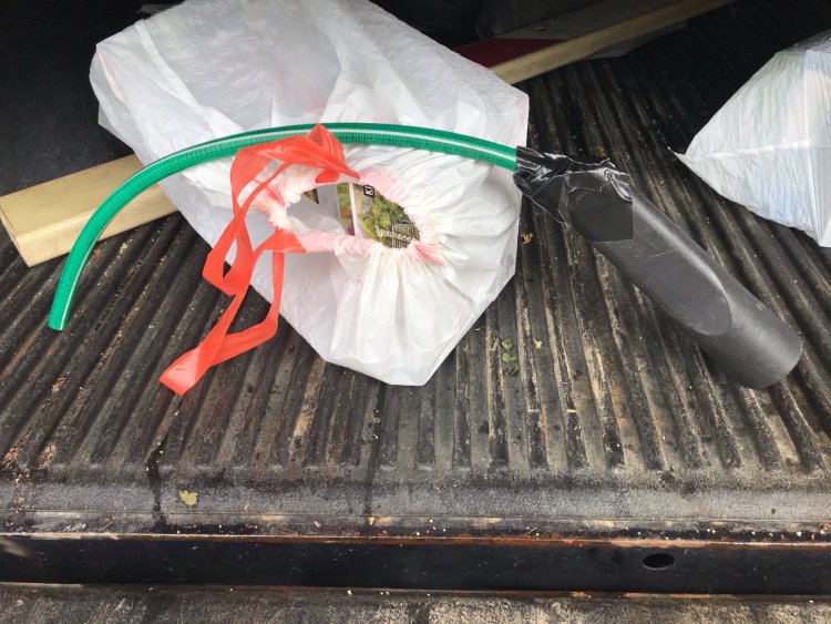

Update on my post. Success! Rigged up small hose attached to shop vac and sucked out the squirrel cage of debris.
Quiet fan now, without having to drop the blower motor/fan. Thanks for the advice. Now to keep em from getting in.

THANK YOU!!! I had the same whirling sound after changing the cabin filter. I duct taped a smaller flexible hose to my shop vac, hand fed it down into the blower, and got whatever small debris was causing the problem!!
