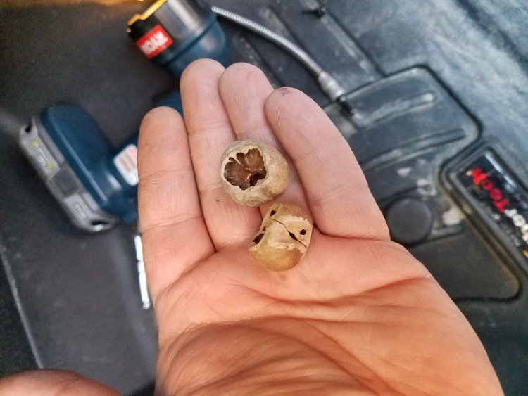

Yep, I know the woes. I found a 1.5” piece of styrofoam in the fan. Fixed it right up after I pulled out that piece of debris.

Duct taped a 3/4” plastic tubing to shop vac hose to assist in removing whatever debris that was causing the roar. It worked!
