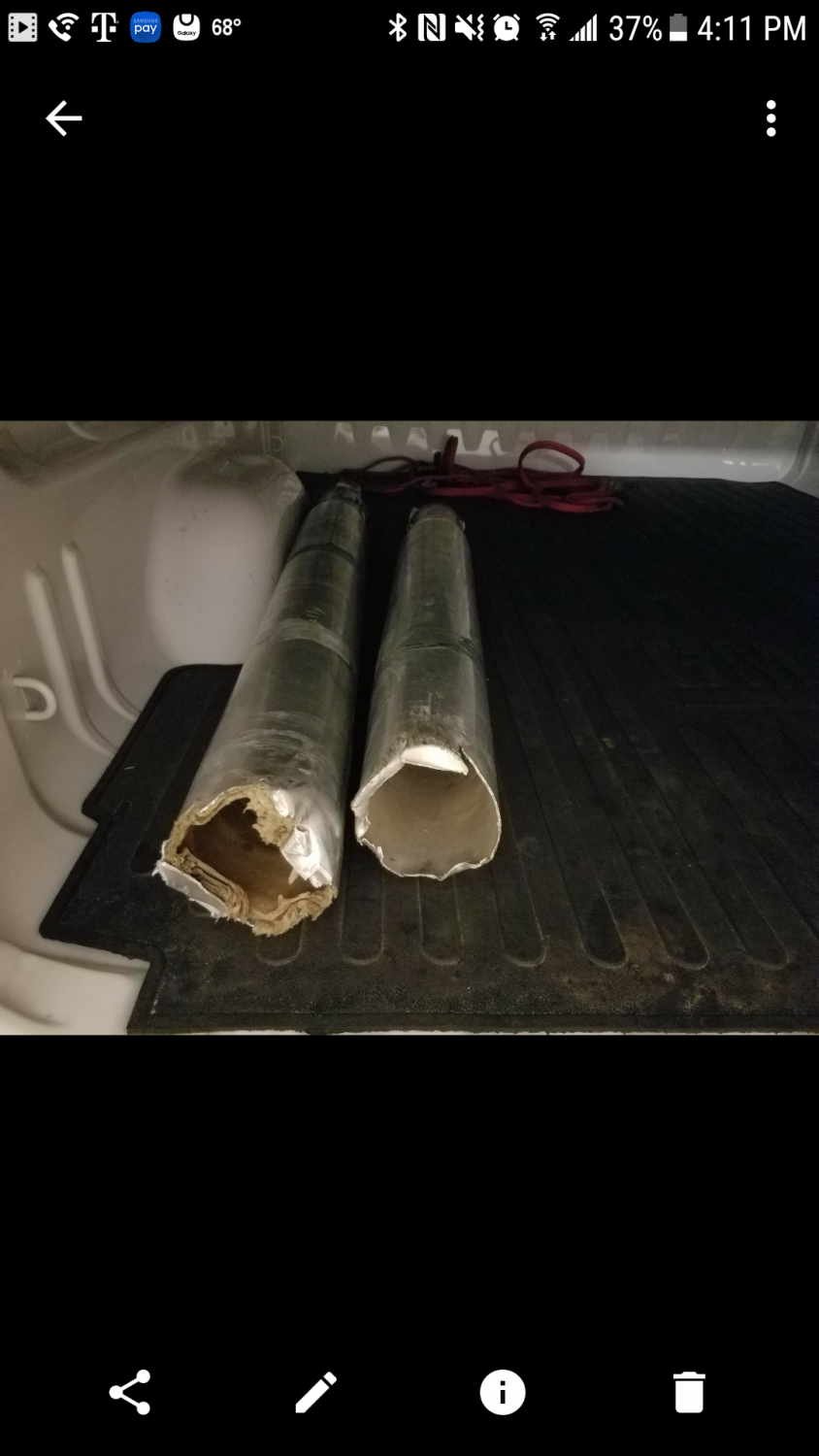

I just wanted to let everyone know that if you are running the 3.73 gear that the driveshafts critical speed is around 115.It will I REAPEAT WILL start shaking and tear apart in the center at these speeds.I had one rip apart after a dyno tune and replaced the shaft with another factory one and it starts shaking around 115ish.These driveshafts are very thin walled and have cardboard in them that cant take the stress.

Technically it's critical frequency and not stress. Sounds crazy but if the material were actually thinner it would perform better with regard to high speed. It may then lose enough strength that it couldn't handle the torque, but it wouldn't become unstable due to speed.

Well according to what I was told if the walls were thicker the diameter could be smaller and that would raise critical speed.It has an amazing tune done by the same guys who do some of the street outlaw tuning and I make the payments so I will do with it how I choose.Regardless these driveshafts are garbage.I will be opting for a high performance aluminum piece very soon.And yes the critical speed of the shaft caused jump roping of the driveshaft and the stress at the work hardened area fails.
That's unbelievable that it's made that thin wrapped around cardboard.
I don't know anything about driveshaft construction, but is that normal theses days, do a lot of trucks use that kind of construction to make a driveshaft??

With such a thin wall...would think at some point road trash would either dent or puncture it. Kinda crazy to see that. Thanks for sharing.

Yup, they've used the aluminum driveshaft in the duramax since 01 in crew-cab short beds - Quite a few switch to a custom aluminum one for weight savings (I want too say the steel version weighs close to 40lbs or so).
They're also fairly strong, guys are running well over 1700ft lbs. with them; but those are 5inch diameter shafts.
I had mine made in San Antonio. I had seen videos of them coming apart on dynos and some places around here wont put a 14+ GM truck on a dyno with stock shaft.
Mine is heavier than stock and its 5" in diameter, the wall is much thicker and rated at 175mph with 3.73's. Not that I will ever go that fast in my truck but at least I know it wont come apart on me.

​This is what happened to my 2004 Sierra Crew Cab at 108mph. Crossed the beams at the 1/4 mile and it let go.
Real good feeling cruising down the interstate at 80mph knowing that another 30 to 35mph she my grenade. Ah living on the edge. And yes I know there governed not to run that fast but still.
