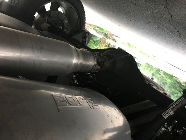

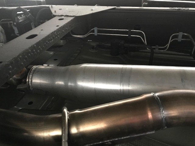

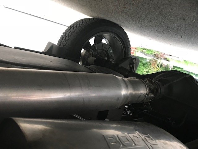

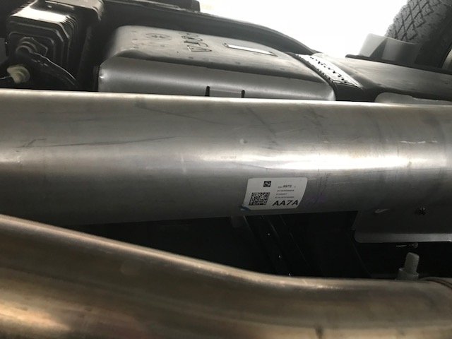

Dang man those little driveshafts twist up like pretzels. looks like this 18 6.2 has a bit larger aluminum driveshaft, I am not sure if that is good or bad thing after reading this thread?
Well according to what I was told if the walls were thicker the diameter could be smaller and that would raise critical speed.It has an amazing tune done by the same guys who do some of the street outlaw tuning and I make the payments so I will do with it how I choose.Regardless these driveshafts are garbage.I will be opting for a high performance aluminum piece very soon.And yes the critical speed of the shaft caused jump roping of the driveshaft and the stress at the work hardened area fails.
I’ve got to agree with you. In all seriousness, the information on the drive shaft is good to know. Who would’ve known there’s a card board roll in these things, these engines are always competing with other manufacturers on power and acceleration as well as durability. If and when you do buy another driveshaft please let us know. More power to you bud, you’re paying for it so make sure to enjoy every bit of your dollar just PLEASE be safe and courteous to others. I wonder what material the driveshafts are made of in the competitors? You do know GM had lots of driveshaft recalls in the 14’s and 15’s some years back for being unstable creating vibrations at higher speeds.
Thanks for the pics, I was wondering about my 18 6.2 as well
