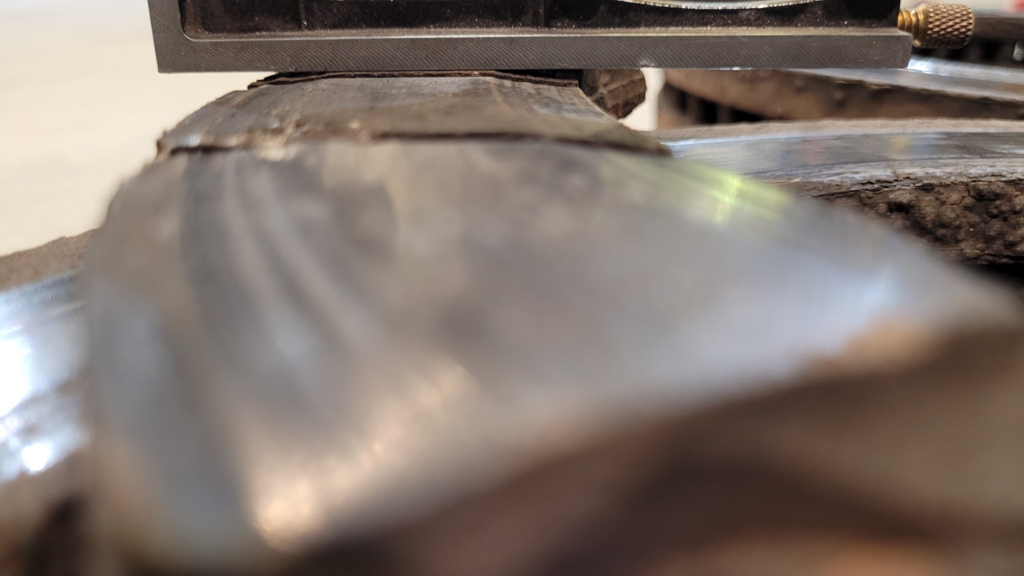

So a six year, 42k mile update to this, yep the brakes always have weak.  Just now getting around to figuring out why.  They were down about 50% in contact area on the front.  Rear looks ok.20230319_111525.thumb.jpg.35e9173654ddc411ae927ab600a85ee1.jpg20230319_112120.thumb.jpg.ae2c84950452a8fb7745e75cd62f887e.jpg

Whilst not the same vehicle or system, our 2019 Honda Odyssey brakes were doing a similar thing.  It would take 2-3 pumps to get them to engage 100%.  If you put the pedal down, it was like they were 25-50% of normal.  Dealer did a brake fluid flush as there was a TSB, no change.  It wasn't until I put new brake pads on that they finally started working correctly.  I changed out the rotors after that as well.  Been going good for a year now.  In the future, any brake issues like that, brake pads and/or rotors will be the 1st thing checked.
