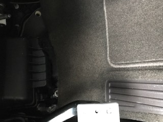

To power the relay, I purchased the GM pin connector for access to the up fitter module under the dash. I then only had to run one wire from inside the cab to the relay under the hood. I ran this wire through the nipple on the large wiring harness grommet in the firewall. I tried several approaches but ultimately used an 8" piece of coat hanger (with a sharpish point) and pushed from the engine side of the firewall through the nipple in order to break through on the cab side (best i can tell the grommet is actually like two mirror image grommets). Was then able to tape the wire to the coat hanger and pull it back through.

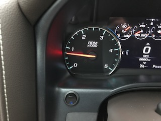

For Inside the cab I bought a PressAir floor mounted pneumatic foot pedal that I put under the carpet (see pics). It has a tube that attaches and operates a switch I also bought from PressAir (no picture, but it is under the dash). I ran a wire from the "accessory on" circuit from the up fitter module to this switch and then ran a wire to my dash mounted / lighted switch. The dash switch also has the ground coming from the up fitter module as well as the wire that runs to the relay under the hood.
I can use the floor foot switch to toggle the lights on an off, assuming of course that the dash switch is "on". As I toggle the lights on and off with the floor switch the light on the dash switch turns on and off, respectively, giving me a visual as to whether the lights are on - although they are pretty bright.
