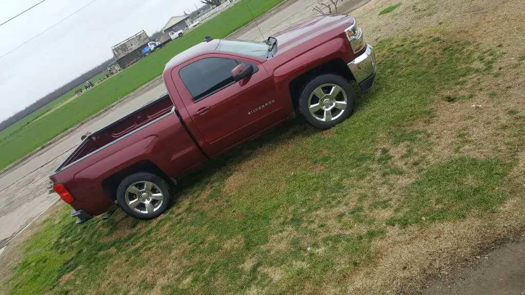

Me and my dad both went to our local shop to drop the rear 3". They installed a 2" drop shackle and they moved some piece above the axle which at the moment can't remember what but I can call tomorrow and double check. Here are our trucks with a 3" drop in the rear.
Mine a 2016 RCSB
Mine a 2016 RCSB

Thanks for the reply boss! Both trucks look good! Exactly the look I'm after!
