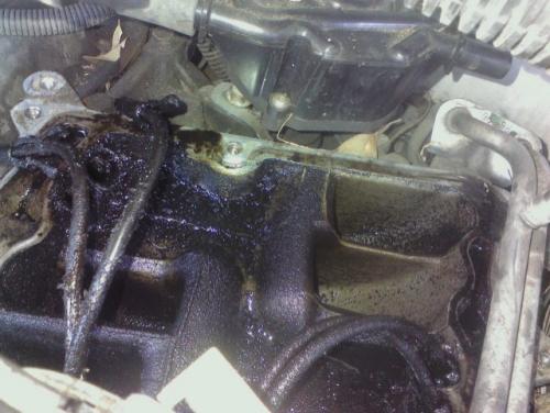

I had pulled #1 plug last weekend and it was pretty black. I checked it today and it was a light brown color, like it should be, as if all the soot had burned off it. I checked all the plugs. the front four were fine, the rear 4 were wet. Gap was about .057, was told it should be .060.

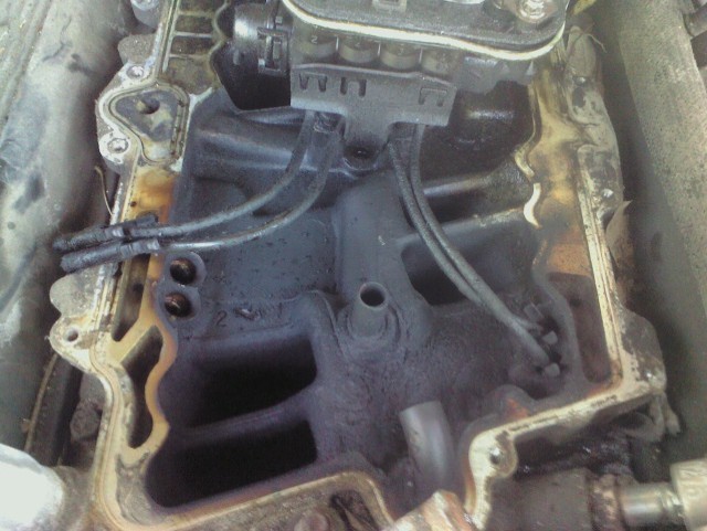

I thought they might be wet with gas, so I pulled off the upper intake manifold. It was pretty filthy inside, but I didn't see any leaking fuel anywhere. There was a lot of oil in the back half, so I am thinking the wetness was oil. Looks like the oil was coming in through the PCV valve.
I ran out of time for this weekend. Trying to find out where to go from here.
Cleaning the intake out and replacing the PCV may improve the look of the rear plug, but I don't know that it will fix how the truck is idling.
Is there further analysis I need to do on the 'spider injector' assembly before deeming it 'good'? It is the original, as far as I know, with the check valve type injectors. There is a lot of crud build up everywhere except right at the end where the 'ball bearing' is visible.
I have a scanner that will read fuel trim, spark advance, O2 readings, etc. But not sure where to find numbers to compare them to. I've worked on lots of vehicles, but this is the newest one--and without a trouble code not sure what might be going on with it.
Any suggestions on where to start/what to check. I don't want to just start replacing parts willy nilly. That being said, I don't mind spending money on it. Its been a good work horse, and other than routine maintenance and standard stuff (alternators, water pump, etc) its never given me any problems.

Ahh, the spider. Another one of GM's fantastic brainstorms! :sick:
If there was any pooling gas visible when you first removed the intake, time to replace the spider. I suspect your regulator is worn out too, since you're seeing bleed-down when engine is off. Should remain steady for a few minutes without dropping more than a few PSI. Can't recall if the regulator comes with a new assembly - I believe it does, but don't quote me on that.
There's an updated design out too - you appear to have the 1st design. I'm willing to bet a few lines are cracked and leaking. If these systems don't have a specific pressure in each of the "legs" of the spider, it won't be enough to overcome the spring tension of the pintle, thus keeping the injector closed. If you're right on the borderline pressure-wise, it may spit and spurt fuel, resulting in a lean misfire, or dead miss. If the injector fails completely, you get pig rich misfires, which is what sounds like you have going on here.
Make sure you're sitting down when you price the assembly out, however ... :uhoh:
After reading through this quickly, I believe you've got a bad regulator. I'd still replace the whole 9 yards though, IMO:

I havn't had time to work on the truck this week. What I am thinking of doing is putting it back together like it is (albeit with new gaskets). Then I can run it and check the vaccuum, check the plug wires (which were new before parked, but that doesn't rule them out). I can check the EGR, etc.
The spider isn't leaking, so I can leave well enough alone. What are your thoughts on the Regulator? The pressure does drop randomly after cycling it a number of times. I understand the fuel can't just keep building up forever, but it seems strange to me that it drops, even to Zero sometimes. I'm leaning towards installing the new one, since there is no way to test just the regulator. I understand that most failures occur with diaphragm, which causes a leak. I have NO leaks. Just thinking perhaps it is failing in a different way.
The reason the rear 4 plugs were wet was oil had collected on the intake from the PCV. The intake was wet from the PCV inlet back (the engine is sloped in that direction, for what that's worth). The PCV passes the rattle test, but since its only 4 bucks, was going to just replace it.
I can always take it all back apart.
Was hoping to put it back together this morning, but the wife wanted to go out, so I am kid-sitting. Where the truck is parked is on a busy street, so I don't dare take the young ones with me when most of my focus would be elsewhere.
Did take two cans of carb cleaner and cleaned the oil/gunk off the intake (that thing is actually a silver color, who knew?). Gently washed the spider and plenum with gas.
The plenum gasket looks pretty done to me (looks flattened), so I want to replace it.
