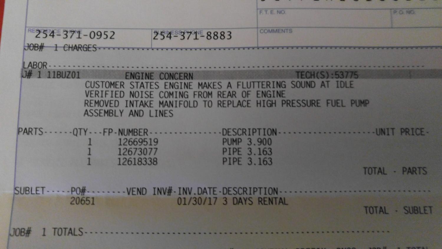

I had the same noise(squeak chirp) on my 2016.
After numerous attempts this is what my dealership found. And it fixed it.

[mention=126037]Haider320[/mention] I was just going to send you a message to make sure you saw the video in the first post. It certainly sounds like what you were describing by a blinker type noise. The post above yours says they replaced the high pressure fuel pump and it fixed the issue for another member who was experiencing the same noise.
Yes, thanks.  I just read that.  On the YouTube link, there are several guys saying they have the same sound. Either GM has some faulty fuel pumps, or some of them just sound like that. My best friend has an 18 and he says his makes the same sound like mine.  Kinda like the vibration issue.  Some have it, some don't.
