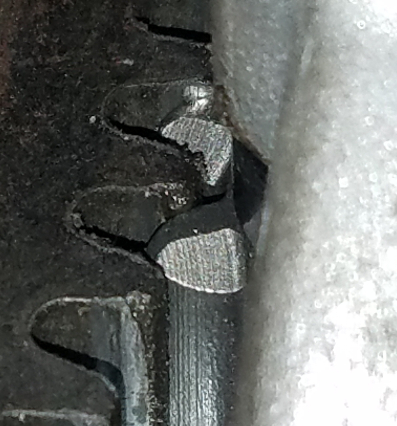

Just a comment on Duralast. I put a Duralast Gold on my truck and it worked fine for a while. It then started intermittently not engaging the flex plate and making that terrible screeching sound. I went around and around with it. Shims, no shims, etc.
I finally took it out and jumped it from the battery and observed the pinion gear throw. With the gear extended and the motor turning there was about 3/16" play in the pinion gear sliding on the shaft due to sloppy tolerances on the lever that throws out the pinion gear. That slop allows the gear to extend but not engage at times when the flex plate/pinion gear aren't aligned properly at the beginning. It would hit the flex plate gear and bounce back out of the gear but not far enough to totally disengage.
I had a friend that loaned me a GM starter from his Camaro that he had left over after replacing it with a high torque unit. The play on that GM motor pinion was about 1/16".
I swapped out the mounting part of the motor, putting the mount from the truck on the GM starter and it works OK now.
BUT, the problem with the Duralast sloppy tolerances damaged the flex plate gear. I'll need to replace the flex plate at some point just because of that cheap Duralast motor. So it's not only that they are poor quality, but they can actually damage other parts. It doesn't matter what the warranty is if it's damaging other parts that aren't covered by the warranty.
No more Duralast anything for me.
So if that Duralast is still installed and it's working, expect trouble in the future. IMO, you should replace it now before it damages the flex plate.
