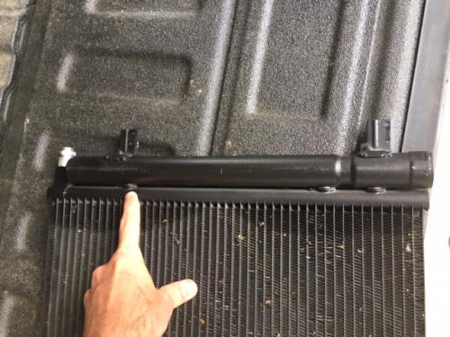

Does anybody have a picture where these condensers are leaking?
I had some pics in the condenser thread as well as a possible failure point for the trans cooler. There are 3 unbrazed joints on the driver's side which very commonly fail. Some of the aftermarket pieces appear to have addressed this issue. I would HIGHLY recommend that you find a fully brazed unit. Some have reported failures in the tubes themselves near the middle, but this seems much more rare.

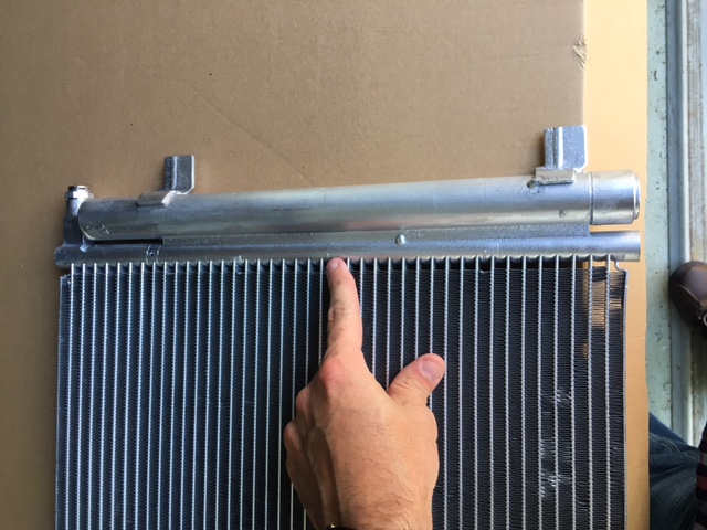

Yeah, the API condenser I just installed has a different attachment of the drier tube (and mounting tabs) to the cooler/condenser tube. Almost a full length braze.
I'm just hoping there's no weakness at the mounting tabs on this API condenser.

That looks absolutely identical to the "ToughOne" that I just installed. All the way down to the box/packaging. Even the screw baggie taped to the back. FYI, reuse the stock coolant tube screw. MUCH nicer. And check trans cooler fittings for burrs.
