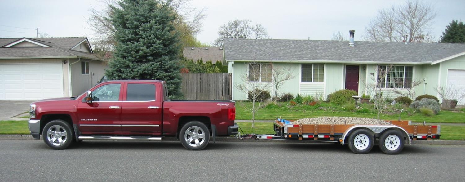

Just an FYI - Towed my camp trailer first time with my new-ish NHT last week, and she sits perfectly level with about the same trailer weight you just towed, and 700 lbs tongue weight scaled at the local gravel pit. I measured at each fender to check. No equalizer hitch.
The rock load below from the same gravel pit was tongue heavy and did make it squat a little.

Krusty- Your pic above is exactly how my truck was sitting with the car hauler. Next time I haul the car or something big I'm going to make a point to do it on E85. See how that feels. Sounds like aside from the airbags.... I can live with everything else. So it's Airbags or new truck. No calculator needed for that one. Worst case it's mirrors and air bags. Still no calculator needed.
