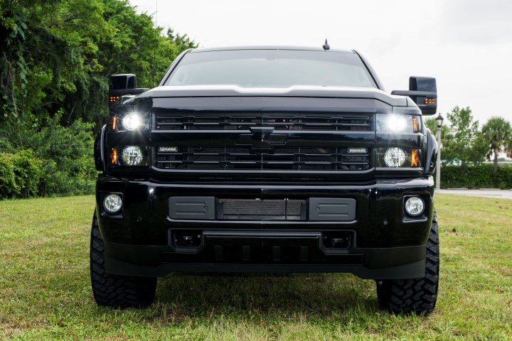

Ah lol. On my 2015 HD when I had it I did the Xenon Depot H11 (low) and 9005 (high) LEDs on my stock headlamps. What a difference! Worth the $$$, and you can with some patience tuck everything into the headlamp assembly.

yes plug in play. I have the canbus adapters, so the DRL work perfect.
It was a tight squeeze getting the cover back on the back of the light with the heatsink.
I shaved down the little plastic nub in the center of the cover to make it fit without forcing.
The bulb, transformer and canbus box are all inside the headlight fixture.
They are also clockable, to get the cutoff just right.

How is the light color? I want to upgrade but I hate the look of the blue leds. I want a nice bright white color. Yours look to be a nice white color in the pic.
The specs say 5700K
To me they look pure white with almost no blue if any.
I didn't want any blue tint either and im very happy with the color.
