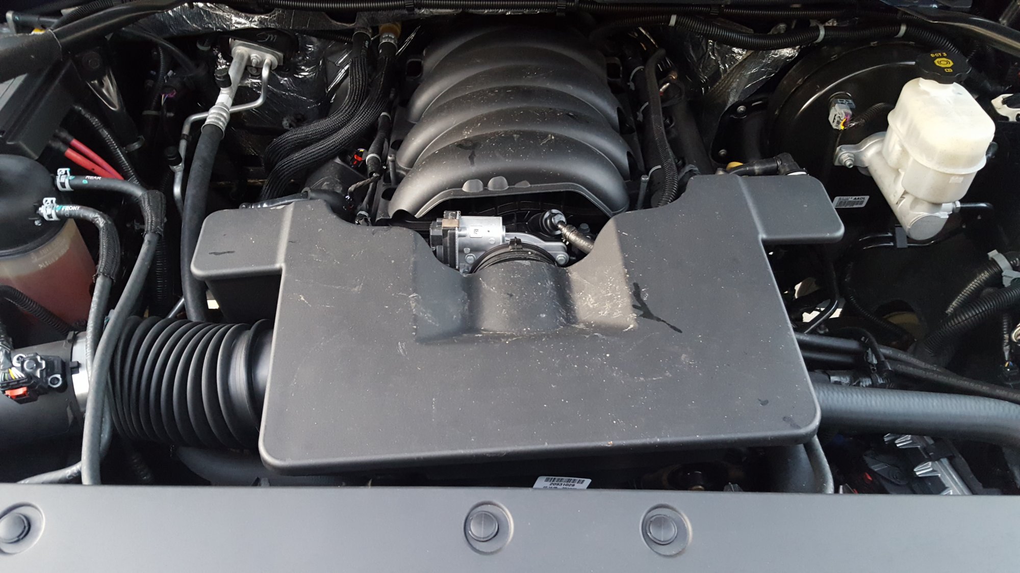

Hey guys, popped the hood to empty my catch can and quickly noticed it appears that something is living under my hood at night because my plastics are dirty,  but the real question i have here is... is the big air intake/silencer crooked ? I dont recall it being like this but... who knows.

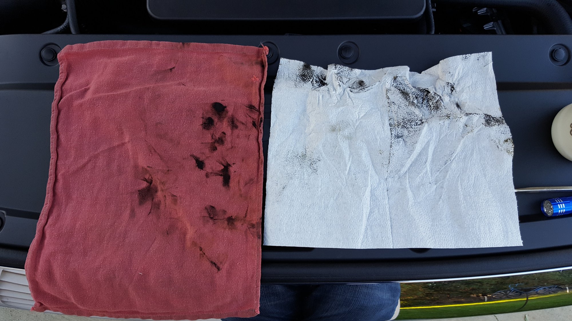

Pics! Also I ended up wiping out the throttle body - it was kind of dirty but didnt seem too oily... catch can is working? Havent cleaned the throttle body since 33k miles ago when I installed the catch can at about 1200 miles.
That does look really crooked!  I think the only thing holding it in is the clamp to the throttle body.  Could loosen it and try to straighten.
Ill have to check into that.  I was kind of wiggling it around, it doesnt really move freely... so strange...  checked my phone for previous engine bay pics, none!
man I wonder what the hell happened.  I think the left side of mine needs to go back towards the firewall if I'm not mistaken.  Look at the tube, its bent outta wack... robbing hp and mpgs:D
I felt all the connections on it, everything felt ok so at least it appears that everything has been functioning.  Tomorrow after work I'll have to have to mess around with it and see what I can do.

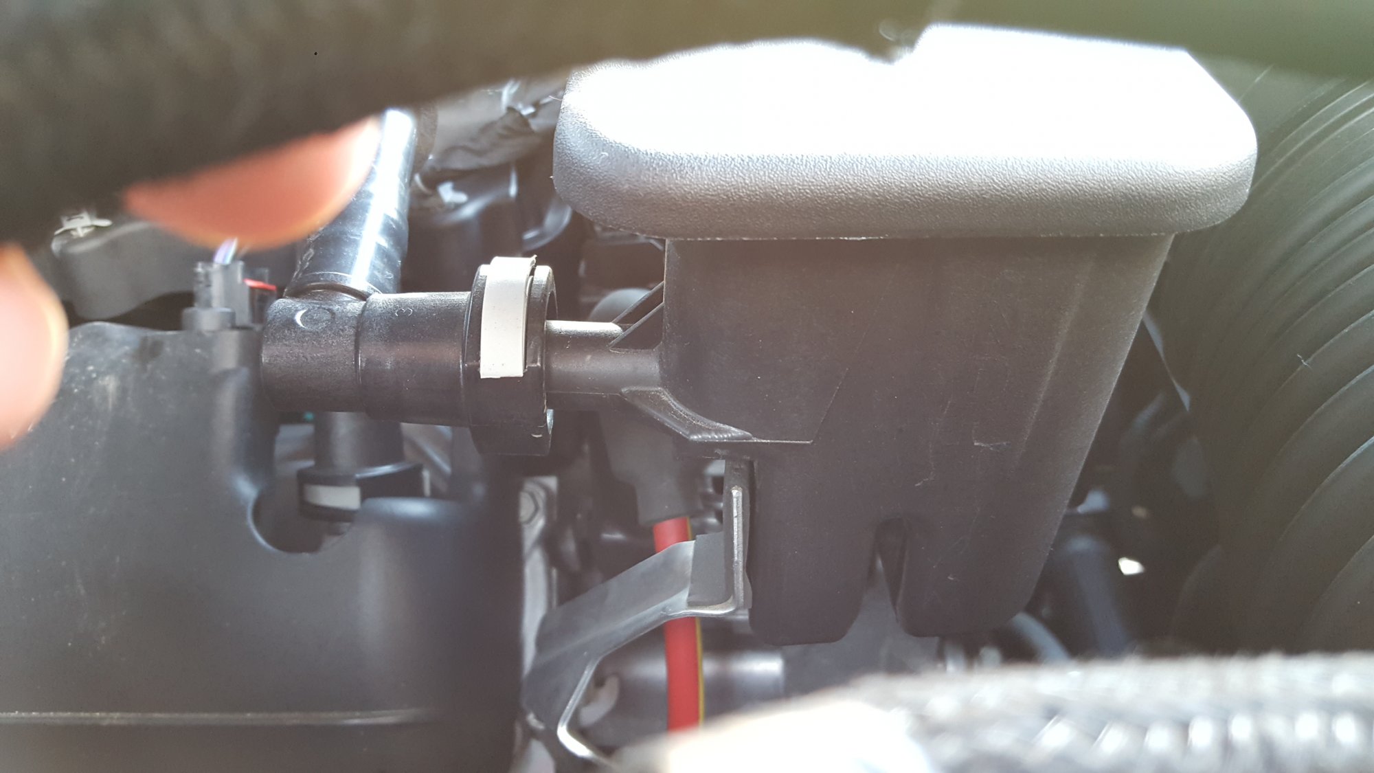

Is anyone able to snap a picture of this from the passenger side of the truck?
There is a notch under the left side of the intake that slides onto, and sits on a bracket that keeps it in position. It looks like from your photo that maybe the intake has come off of the bracket so is now sitting crooked. Maybe the critter crawling around your engine compartment pushed the intake off the bracket?

I think I know exactly which bracket you are talking about, I remember seeing it yesterday when looking into the engine bay from the passenger side.  I remember seeing a notch in the "silencer" and thought hmm I wonder if the bracket should be slid into this notch... I gave it a little tug but it didn't really move much and I wasn't sure how hard I could start tugging on this thing.   I will check it today after work and report back tonight.
