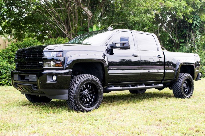

Sorry guys I suck at keeping up with the internet. Anyway I'll try to answer everyone's questions.... I had the leveling kit put on at like 230 miles (trail master 2.5" keys), then control arms at around 600 miles... currently the truck has 0.5" sag from rear to front, and the shop said they can't go any lower with those keys installed... I obviously didn't drive this one much before I had the leveling kit installed but this isn't my first 2500hd either... I still have my 04 2500hd with 302k miles on it, stock keys cranked almost all the way up to level it and it rides better then the '17 I think... anyway here's some pictures to give you guys an idea of how it sits
Should have left the stock keys in it and just cranked them up.
You keep saying that... but my truck drove like a tank.
