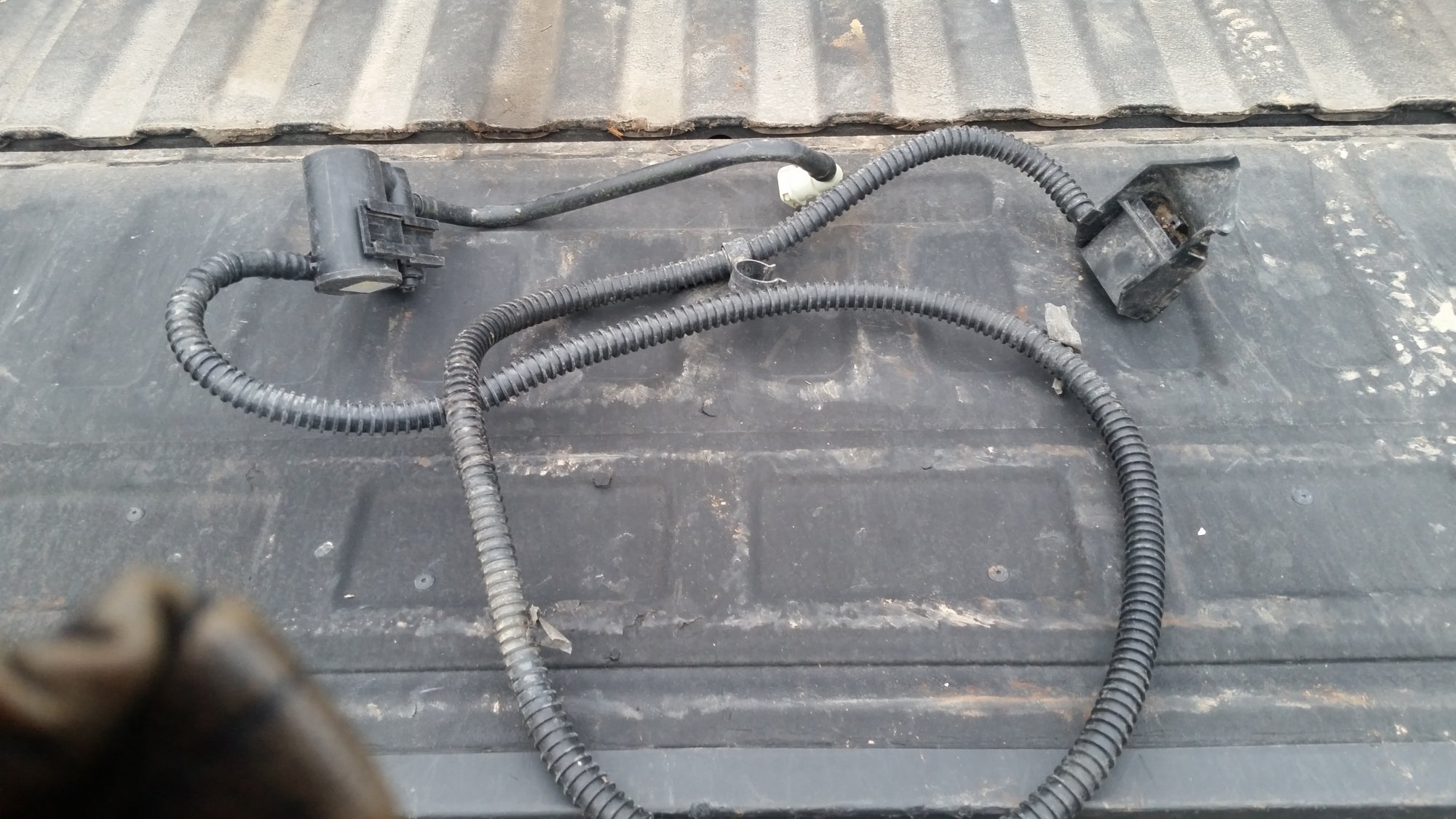

I also replaced the hose from new canister there's what I replaced
