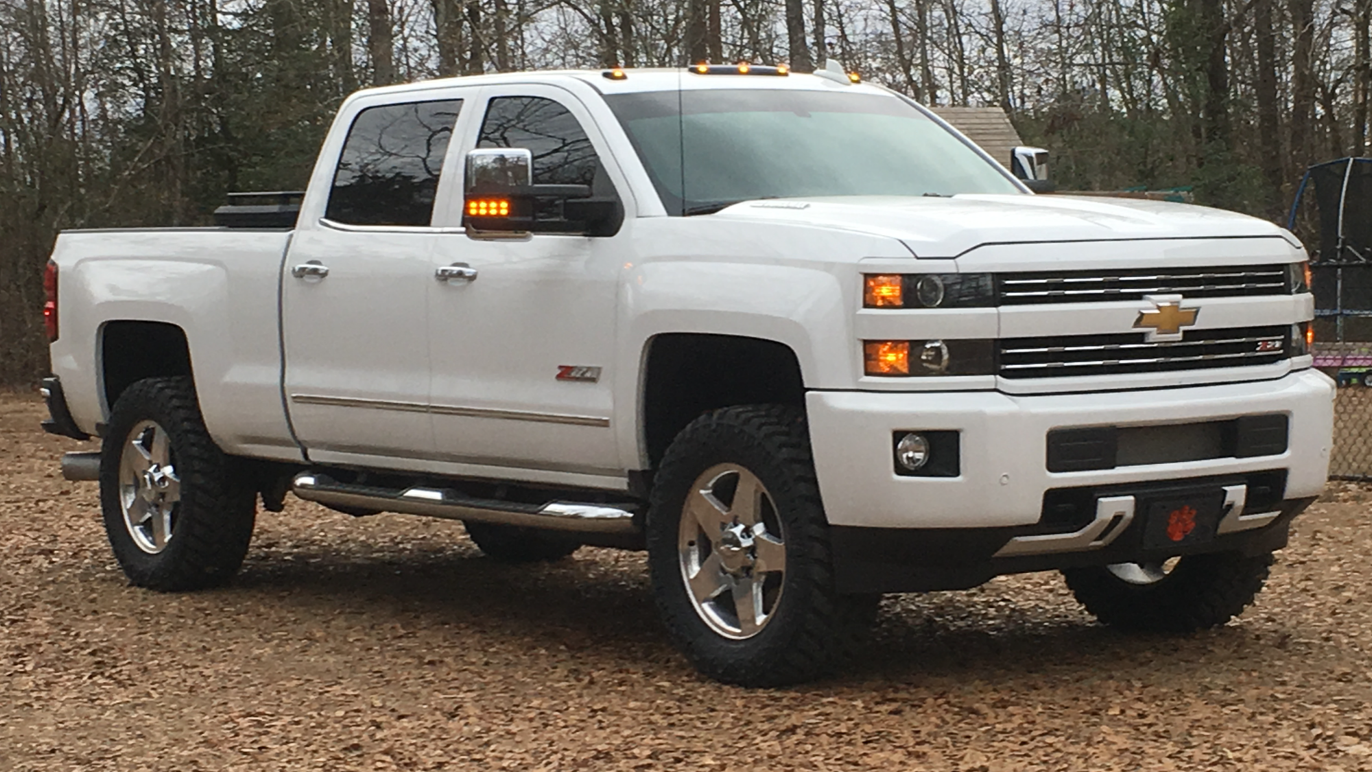

Here's mine 35x12.50 Nitto Trail Grappler with 8 turns on torsion bars and shock extenders. Rubbed a little on frame and sway bar full lock but made steering stop shims on spindles to keep that from happening.
