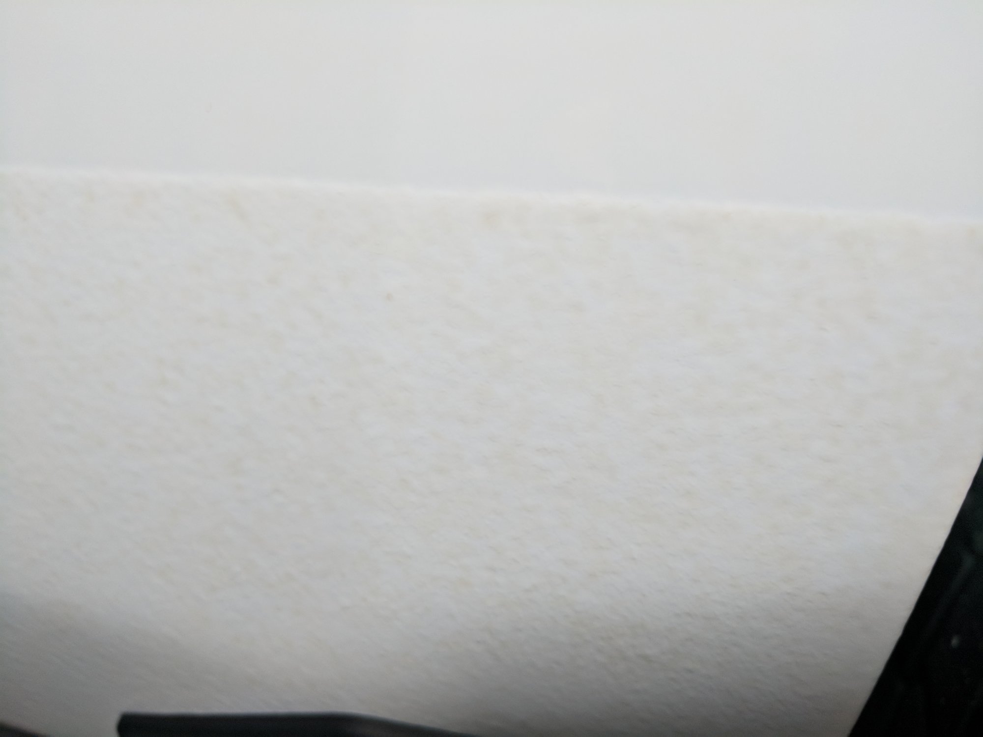

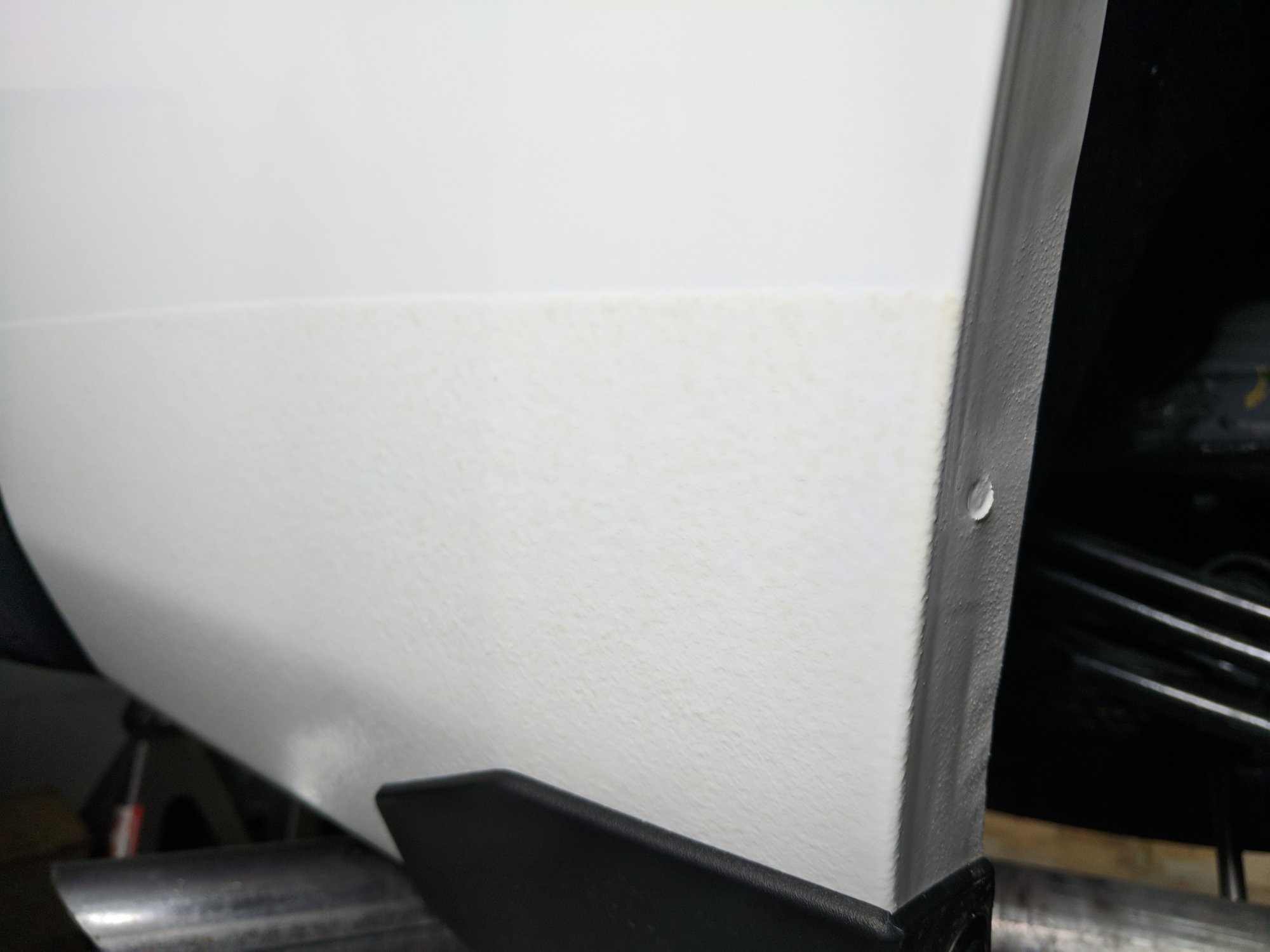

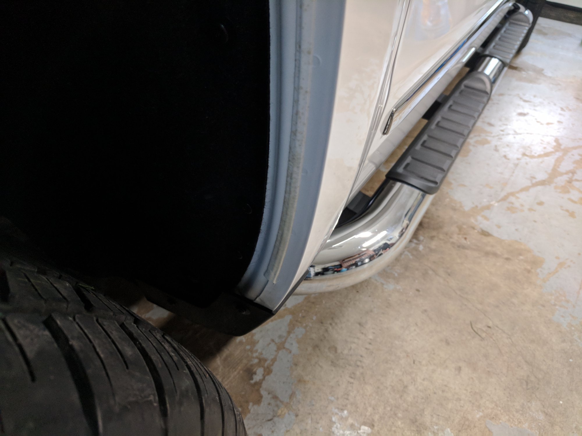

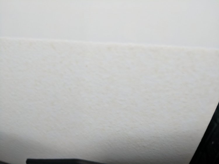

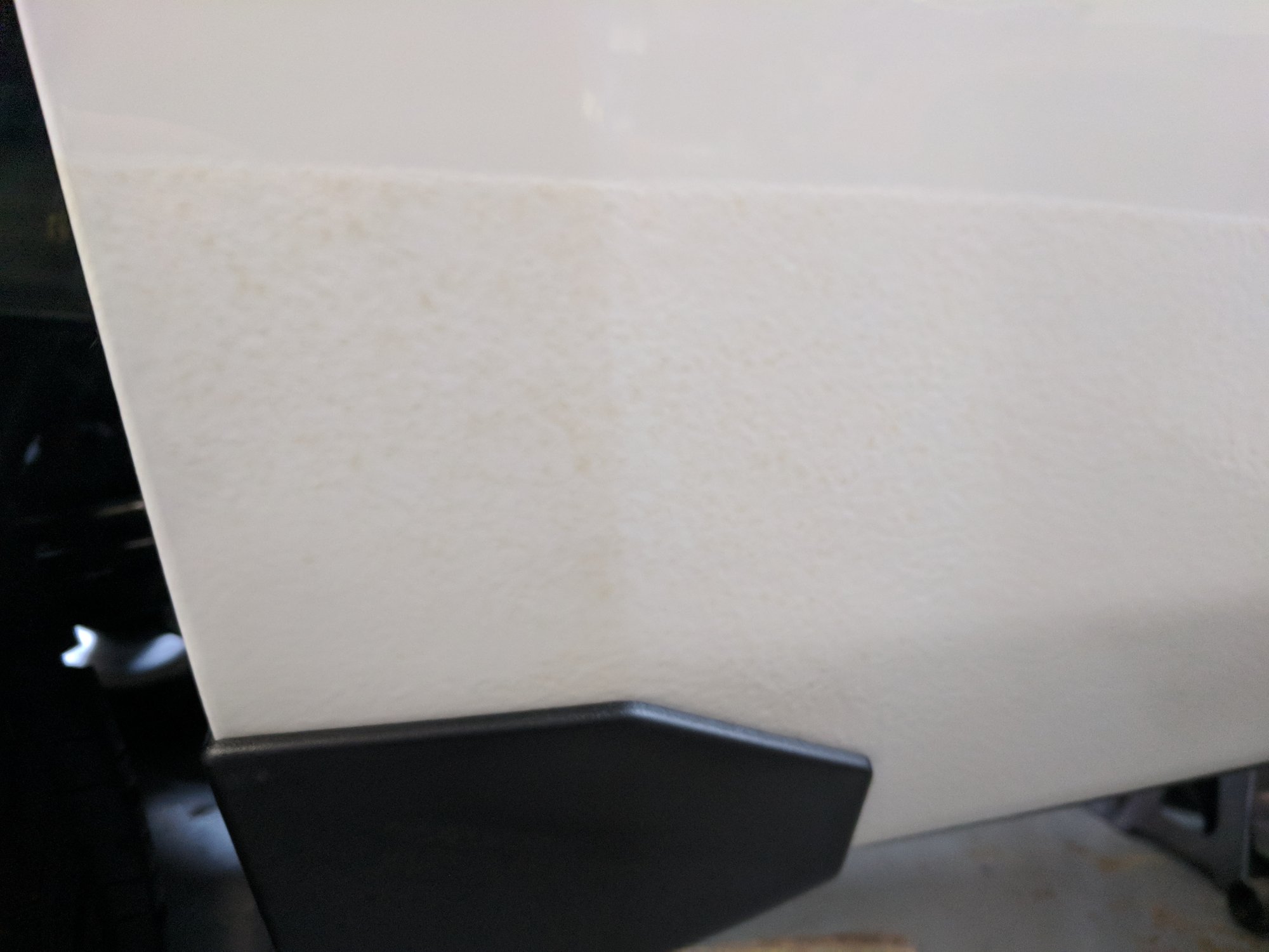

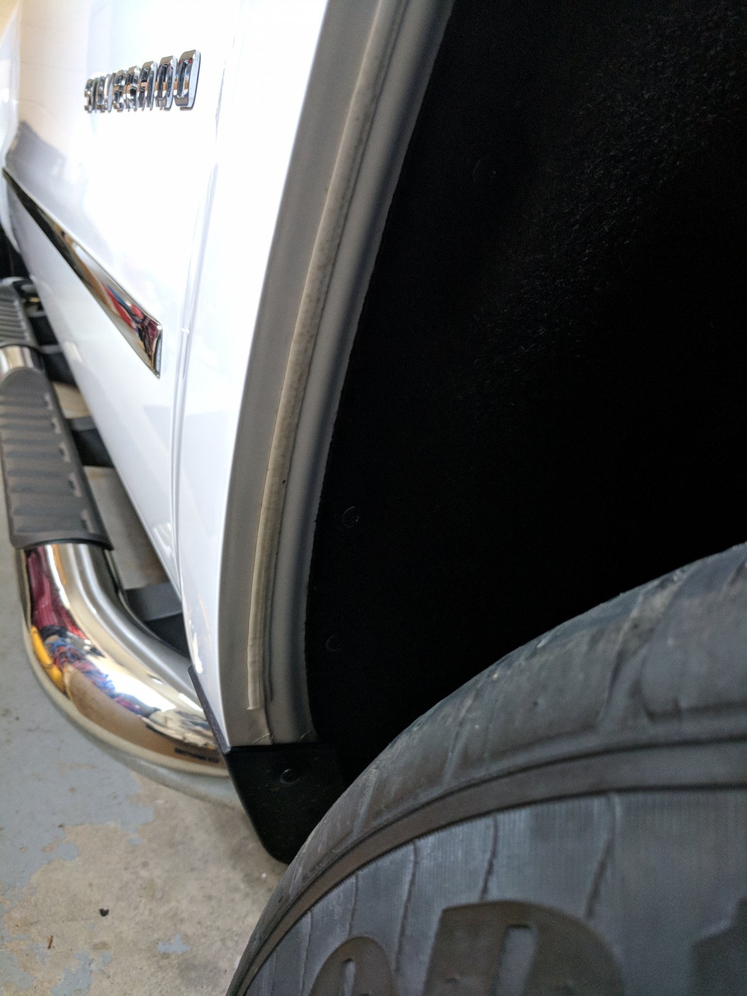

Tried bug and tar, citrus cleaner, goo gone, ppg paint cleaner, Meguiars paint cleaner. It's not on the surface. It is literally stained. And before someone says it's rails dust, no its not.
Everything came off the regular paint, it's just this textured area and the front fender well where the glue strip is. These pictures show it some but out in the sunshine it looks worse.
Is it possible it is a paint defect from the factory? I remember when I bought my truck there was a white truck sitting on the used portion of the lot. I asked the salesman about it and it was a GM buyback because there was contamination under the clear and the original purchaser did not want the truck repaired. I looked the truck over and the paint looked very similar to yours. Of course that dealer could have been lying and the paint defect was from excessive tire dressing being thrown on the truck.
Something is definitely not rite. Sometimes GM customer care looks at these post. Maybe they will chime in. I also found a big blob of paint possibly over spray of the texture paint about 3 inches down from the chrome strip on the driver's door. I cant for the life of me understand how GM let's things like this pass any type of quality inspection.
