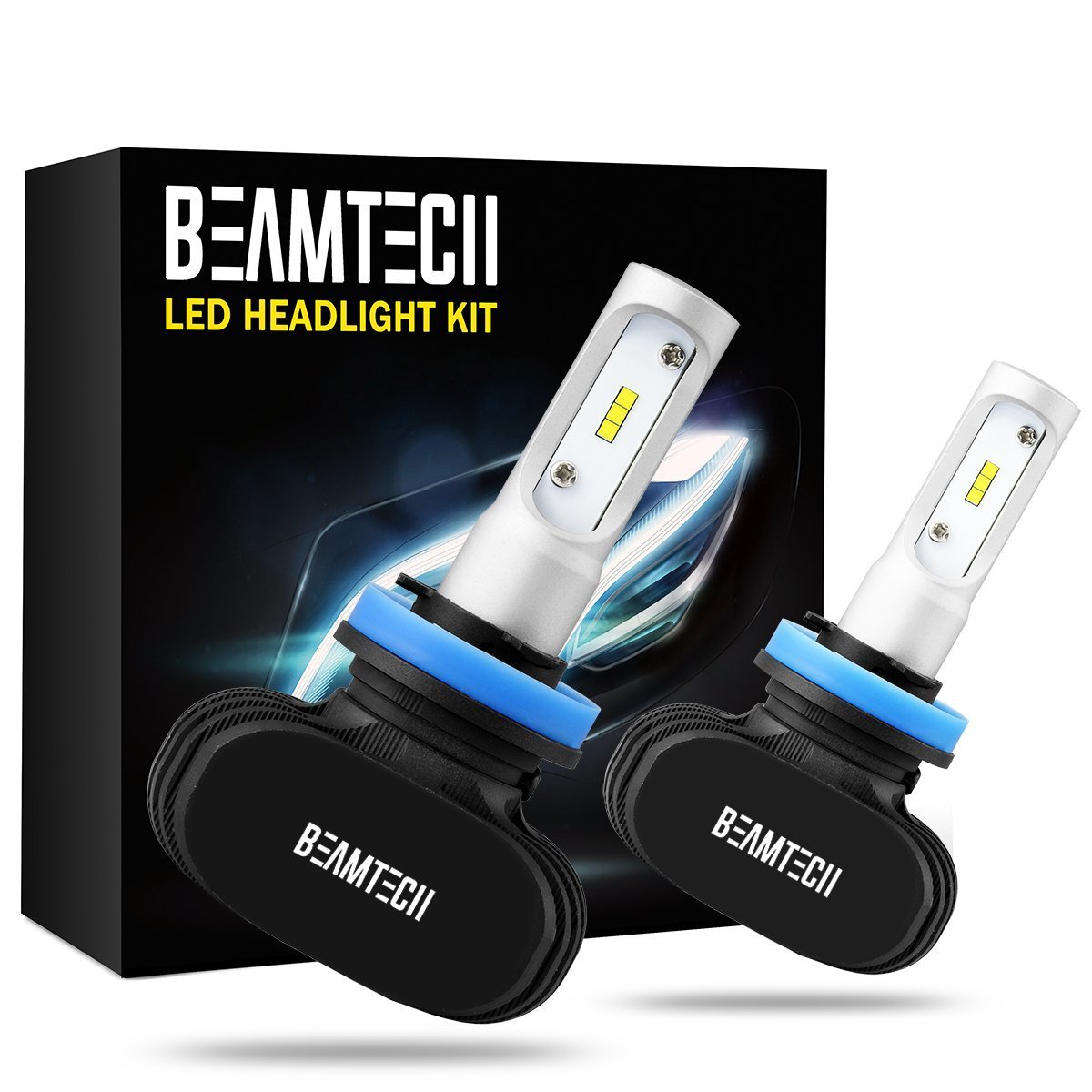

Anyone have experience with this style LED?  They look nice and wondering if anyone used them and got the covers to fit?
Go with VLED Micros.  I have them in my Colorado.  Almost no bigger than the stock headlight bulbs.  Or Xenon Depot will fit.
