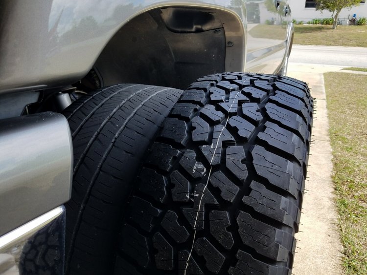

A while back I had posted about wanting to know about a 275/60R20 on a GMT800 series truck. Could not find much info at all... on how it would look and fit. Well I went ahead and got them mounted on my truck... and I can say I am dang pleased.
I wanted to share this incase anyone is looking at the same combo. 2015 Sierra 20" wheels with 275/60R20 Falkens... essentially a 33 inch tire, just over a hair. I have a rough country leveling kit on it with the shock extenders, and the keys are not cranked, I'd say I came up 2 inches over where theold  keys were at previously. CV angle is good... and tires have ZERO rubbing.
The beauty shots...
