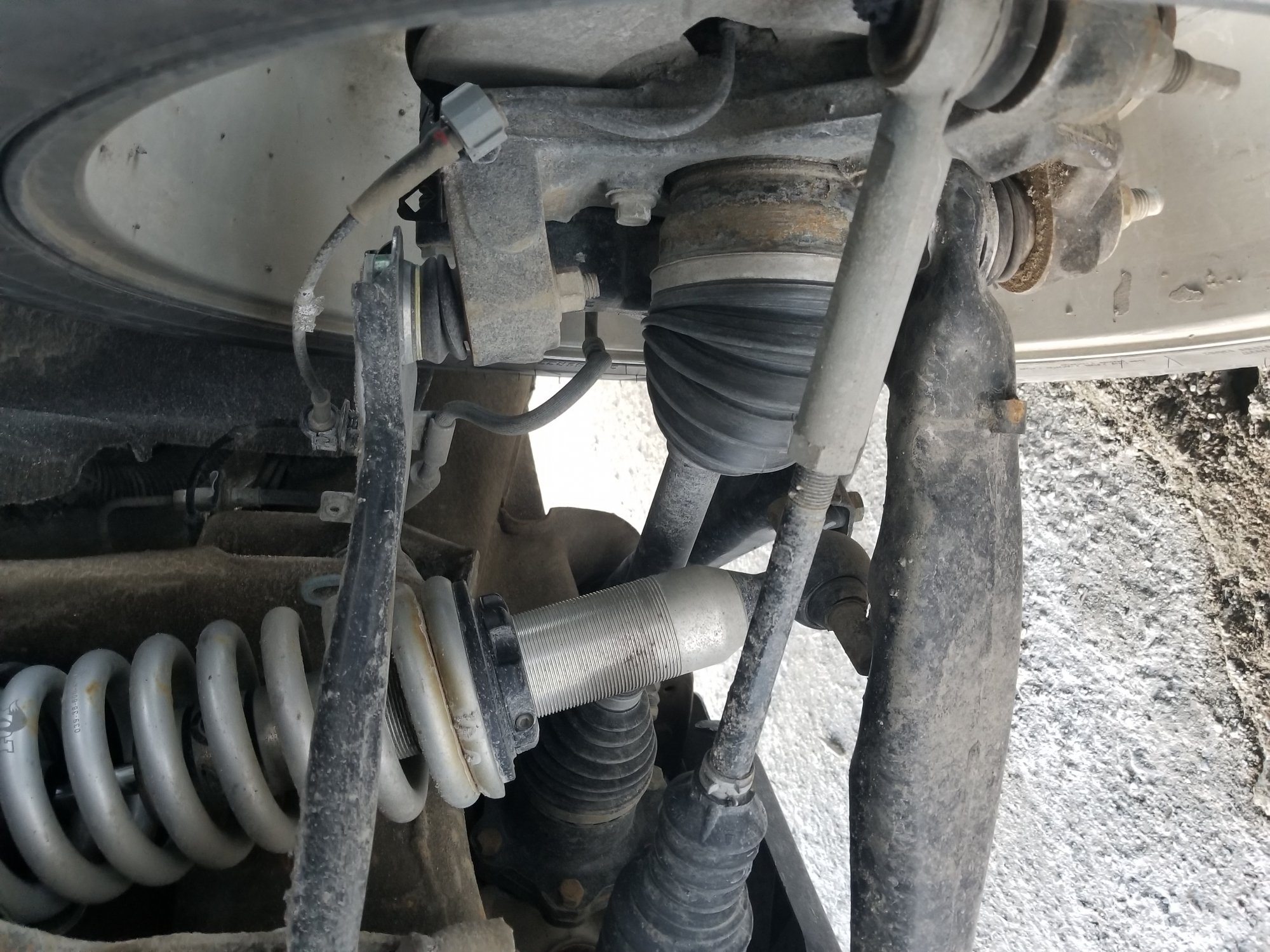

Main goal is the make this truck ride as good as possible, for a reasonable price. I hit the droop stop alot, and it's starting to get annoying. I priced out the cognito balljoin arm, and it was almost 2 grand here in Canada. So im going to go ahead and scratch that off the list lol. I'm going to take some pictures of my balljoin angles and post them on this thread shortly, just feelin lazy rn

That right there is what I might do. Seems like UCA are way too much for the little benefit they would give me right off the bat. That's a wild setup right there, forsure have to find this Ben ya'll speak of. Stay tuned for balljoint angles, just going outside to snap some pictures now.
Edit : Phone's dead, going to charge it to take some pictures.
I have no idea why it's rotated like that. but you could still kinda see it. I thought it was going to be worst the what it is, but the truck is not on even ground. I'll take a better one in a couple hrs.
If you're hitting your droop stops you need to fix that or you're just not going to have a good ride offroad.  Aftermarket UCA's and cutting the stops off (depending on what arms you get) will help.  If that's too expensive for what you get, the better solution for you may be to save up and spend more--a proper 4" lift such as zone or BDS fixes these issues using the stock arms and will provide a much better offroad ride.
