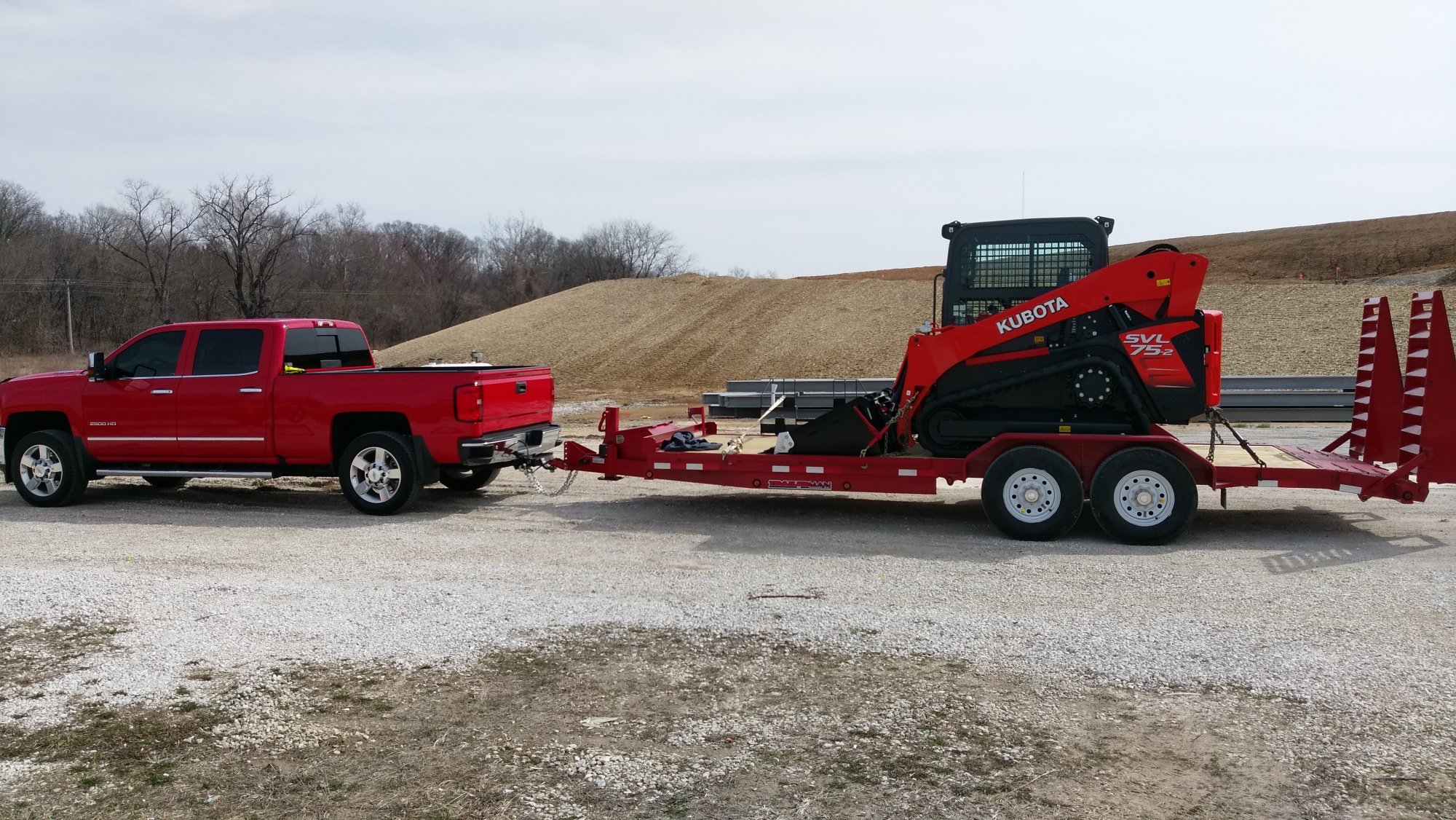

Ditto!   I lowered my 2500 with a set of McGaughy's 2" drop shackles and installed Sumo's.  I can put over a ton of material in the back of the pickup and it still is level. That 2" drop in the back is a world of difference compared to the "cat in heat" factory setting, and with mine, there is still about 1.5" of rake.   Ride and handling greatly improved over stock.   And my pickup is a rural farm use situation.  I have been off road frequently with it on the property and the lowering in the back makes no difference.  I suppose it might if one wants to play in the rocks of Moab.
