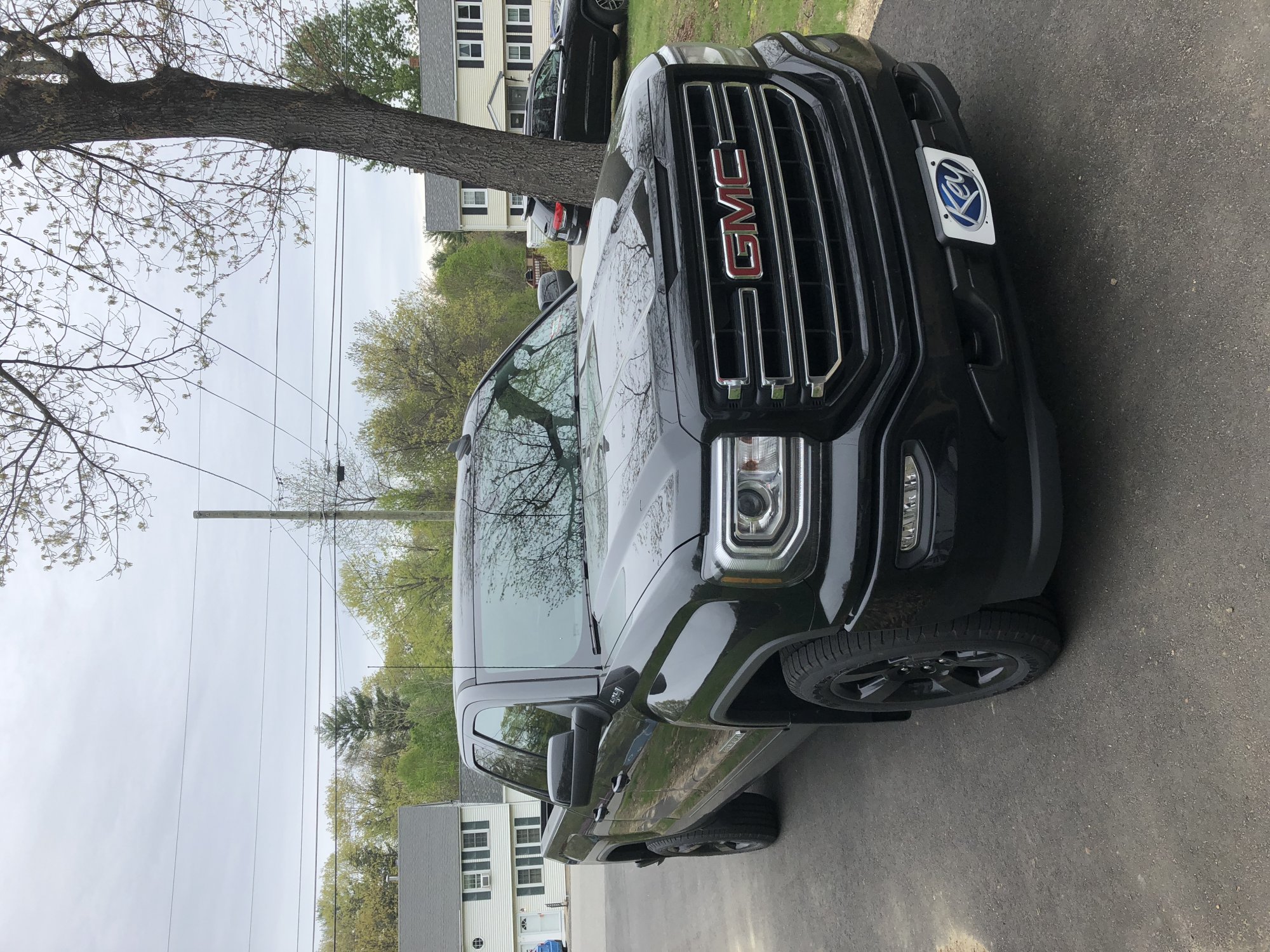

I just bought a 2018  Sierra 1500 and the throttle response is slow. This is my first truck and I love it but I would like to fix that. Anyone have a suggestion?
