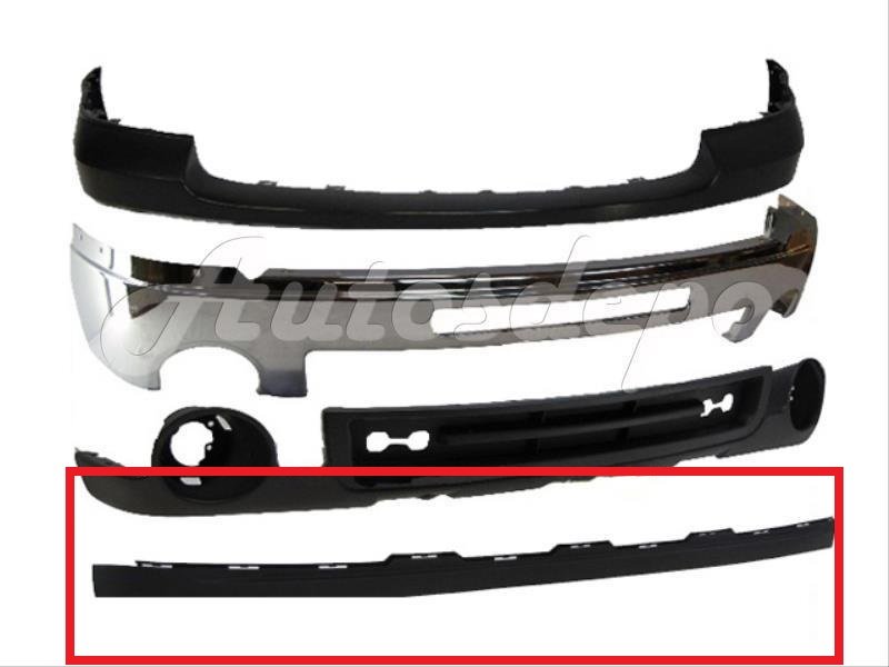

Just curious as the clips the hold my Lower Valance on my 2012 Sierra has broke I have removed it. My question is what does it really do and should I replace it or can I just not bother with it. truck still drives fine. I personally like how it looks without it hanging down. From what I have read online is very mixed thoughts and opinions on what it does and is it needed or not and some people say to replace it some say don't bother others say if the part is cheap might as well replace it. If someone of you experts can shine some more light on if I REALLY need it or not and what purpose it really is serving being on the truck that would be great. I have attached an image indicating the piece I am referring to.

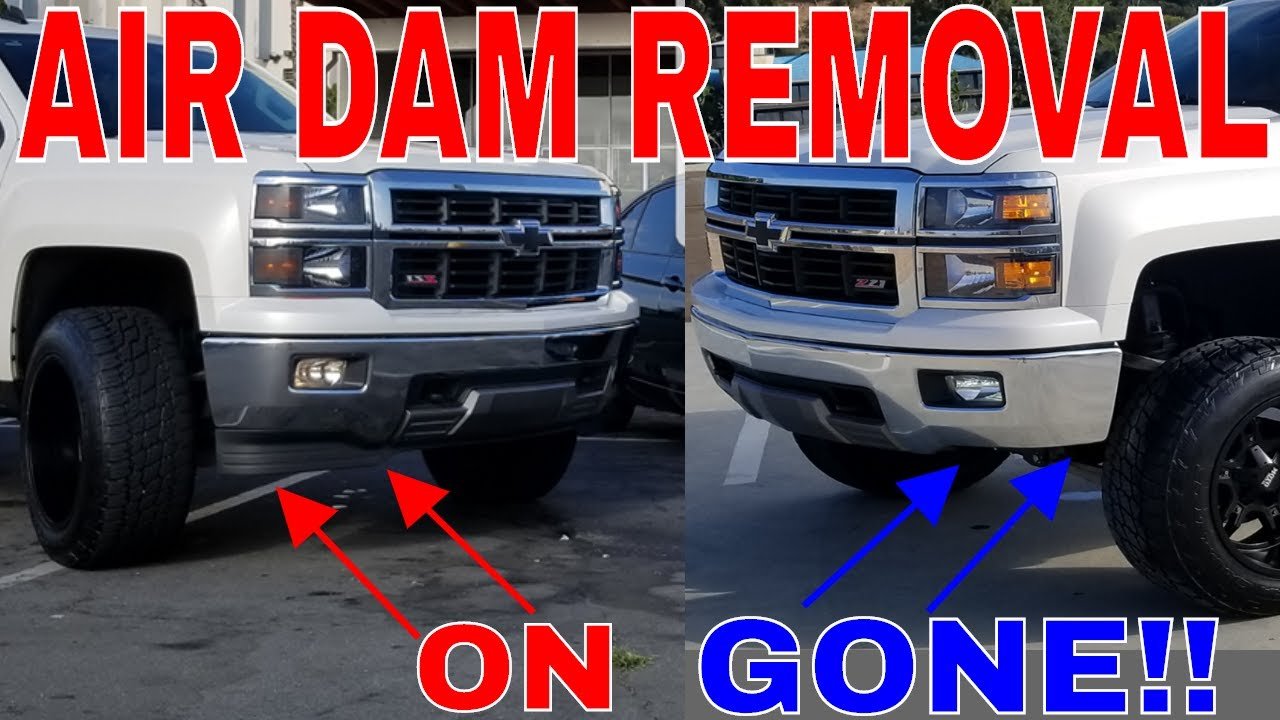

Can you provide a real-life picture of the part in question? Does it look like this:

8 hours ago, starman8tdc said:
Same part in the picture you posted.
