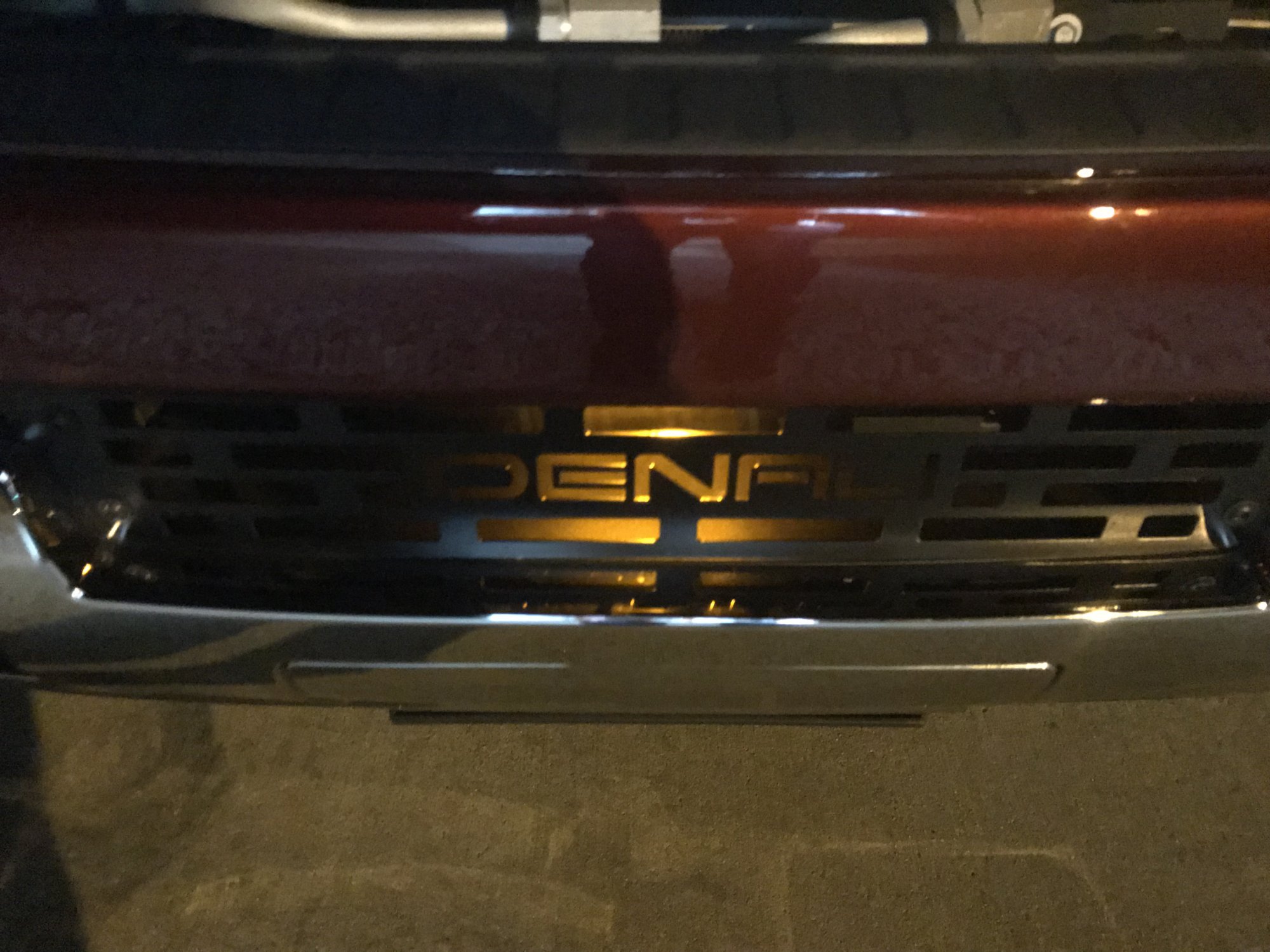

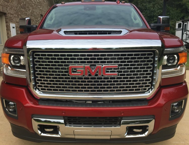

Just did this on my 6.0 Double cab... love the look of extra lights.  I just tapped into the rear trailer wiring at my plug that goes into the box for the Deck lights..

they are the same 3/4" led marker lights.

Thank You -  Now I see what there mounted to day light photo . Must be PLAY time.

At night time it works with the unlock function and the remote start function Since it’s tied into the parking/marker light...So anytime the parking lights are on so are they.

No resistors. I showed in the pics where I tapped into the harness under the frame on drivers side (purple wire with grey). I also added in one behind the new lower grill I installed when I switched out the main grill.
Here is a pic but need to take one of whole truck at night and I will do later.
