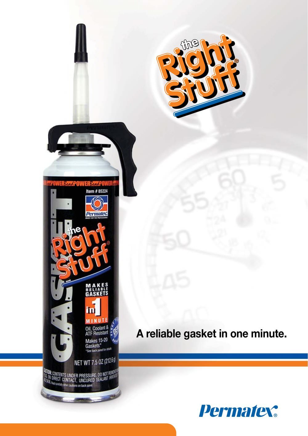

With the old sensor in place:
1)  Soak the whole area in brake cleaner. Scrub the block around the sensor with wire brush. Rinse with brake cleaner.
2)  Repeat step 1.
3)  Allow to dry for 1 hour.
4)  Install new sensor while wearing gloves (to keep skin oil off of parts and block).
5)  Put "gasket maker" in a circle all the way around the sensor on the block, extending out 2 inches, and 1/4"  thick.
6)  Completely coat the entire sensor in 1/4" of gasket maker, extending up 1" of the wire.
7)  Allow to dry for 24 hours.
It will NEVER leak again. If the part fails to report proper readings, you can cut around it with a razor knife for easy removal.
You must use ONLY this specific gasket maker. It is extremely strong, and adheres to clean surfaces better than any other product:
2)  Repeat step 1.
That's a good idea, if it were leaking. It is blowing...every time it has gone out or blows it sprays oil all over the engine and engine compartment. :-(

I have a hard time believing his post was even serious.
Get a new sender from the dealer.  Use Teflon tape on the threads, your son should have been taught how to apply it correctly. You want to wrap the tape around the threads in a clockwise direction when the threaded end is facing you. Wrap 3 complete turns, pulling the tape tight as you wrap it. It needs to start at the first thread and wrap up the threads.  Teflon paste is another option. Ignore the post suggesting permatex, or any other of his suggestions.
