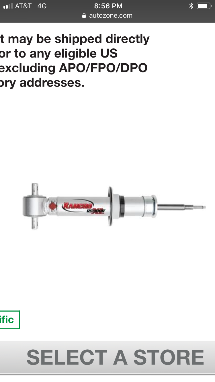

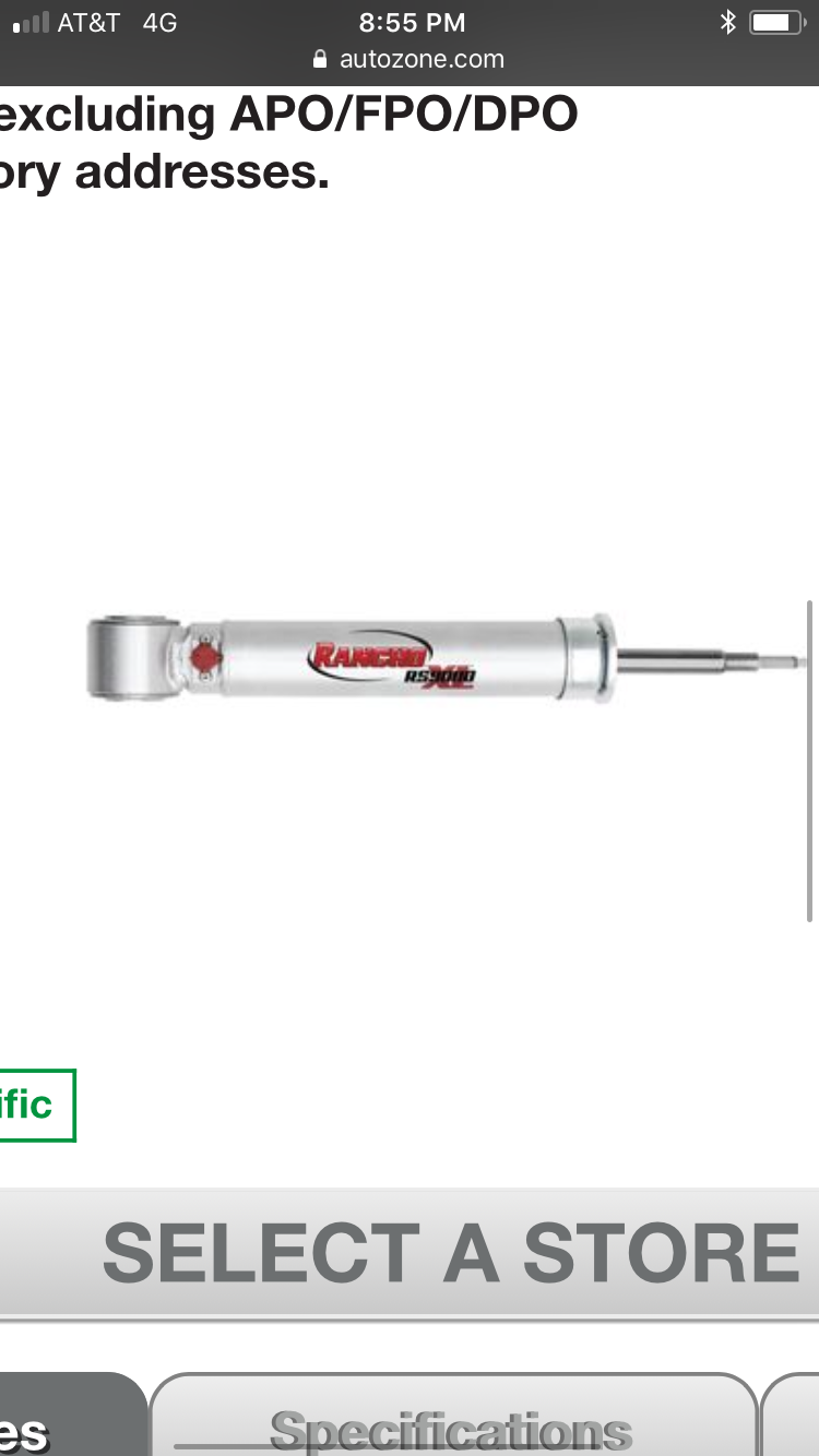

I bought a 2014 Sierra 1500 all terrain (6.2L)that has a 4” sst readylift kit in it. I know I need factory shocks for the front end, my question is , do I need the ones that have the seat for the spring attached to them or the slick ones that don’t.

Go out and stick your head under one of the front tires and look up at the strut. If it’s still the factory style strut it will have the perch (that’s what the OE spring sets on) Rancho RS 999830 would be the stock replacement strut with 0 lift  999832 is the 6” lift part number. Use the GORANCHO.COM site to find your part number then the matching one from junkzone if your ordering your parts from them. I’d check with the manufacturer of the lift to see what they recommend for how much “lift” your strut needs if your not 100% sure it’s 0 (ie. stock) which it should be if the lift kit is using  strut spacers for the lift (I believe the 4” kit does but I’m not ? on that from memory). The other thing to remember is you’ll need a strut compressor tool to swap the springs from the old ones to the new or take them to a shop and have them do it (I’d recommend this). Junkzone probably has a sh!tty azz cheap tool for you to borrow but you better study up on how to use it right if you’ve never done them before and whatever you do DON’T PULL THE ASSEMBLIES  APART WITHOUT THE SPRINGS COMPRESSED this is how people get hurt.

Man you hit the nail on the head. You’re awesome. It’s got the spacer for the lift above the strut. So it’s stock size strut. I just wasn’t sure if the perch was factory and you slid it around the new shock. But I got it now. Thanks. Also, very correct, someone rebadged everything before I bought it and I don’t know jack crap about all terrains. I’m gonna read that thread you shared. And as far as compressing the spring goes, I bought one a back in 2011 when I was going to put a lift on a truck  but it wouldn’t fit around the beefier springs but I feel confident it will with these.
