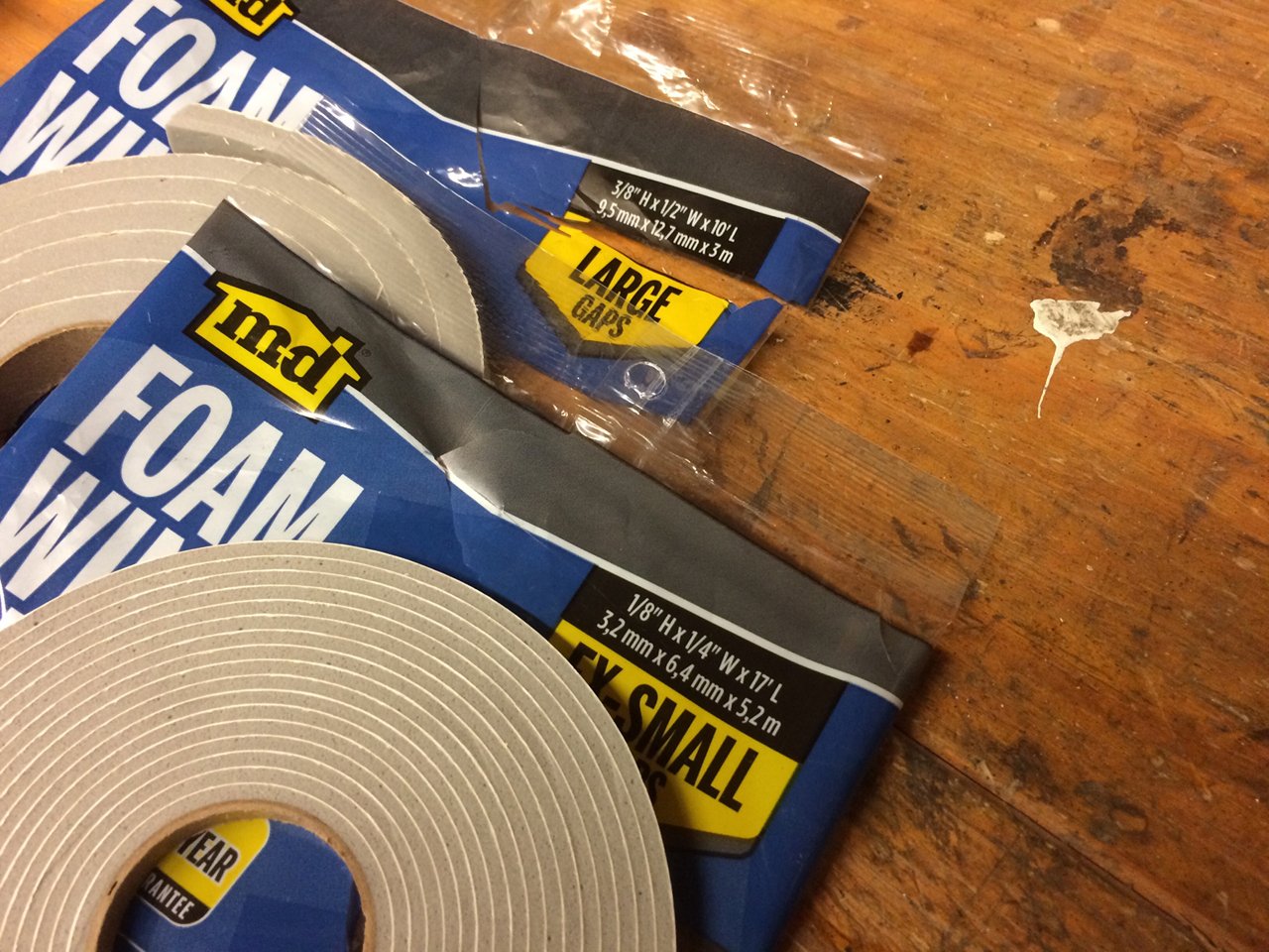

A combination of large (3/8"x1/2") and small (1/8"x1/4") weather stripping worked well for me.

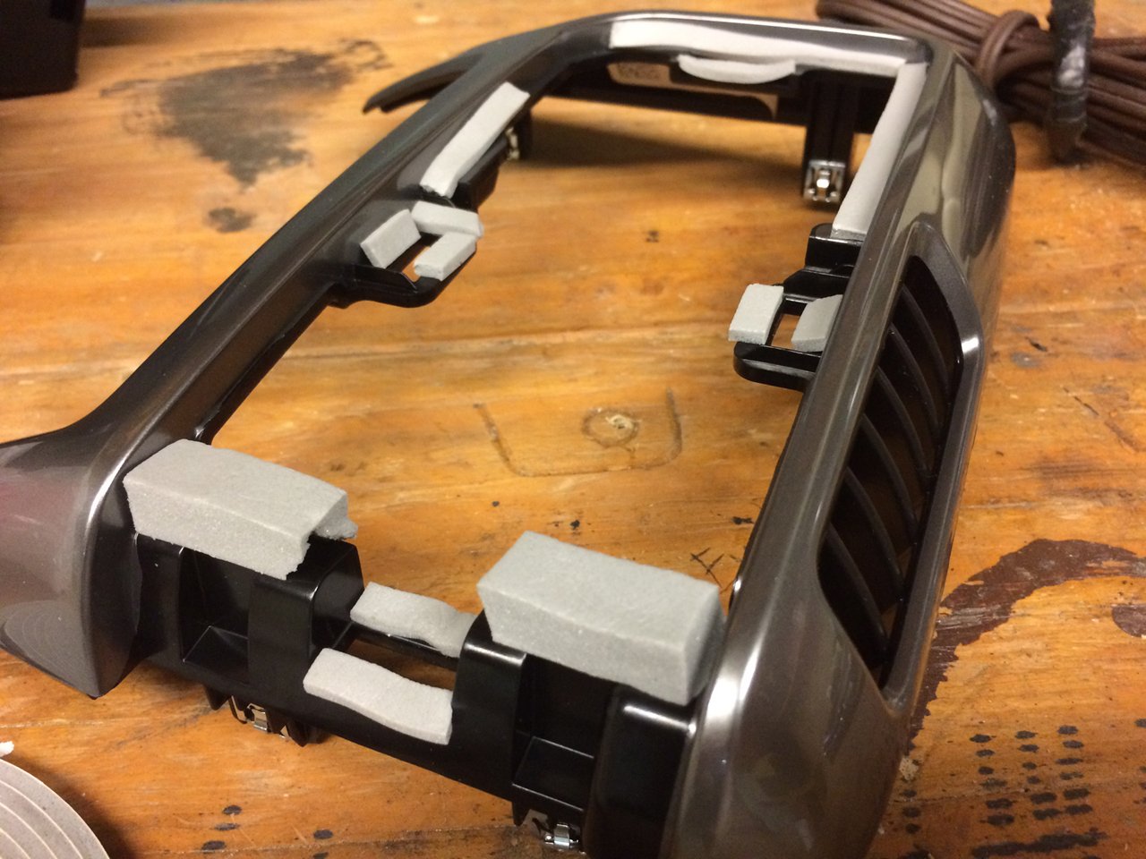

Use a combination of thick and thin on the driver side vent-headlight switch panel.
Two thin pieces are used behind the driver side panel near the clamps that hold the assembly to the dash.

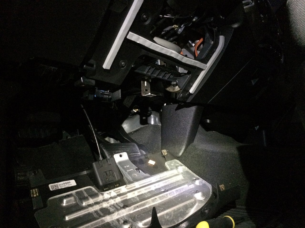

Three large strips are used under the steering wheel. Be sure to check for loose bolts as described here. My bottom two were loose.

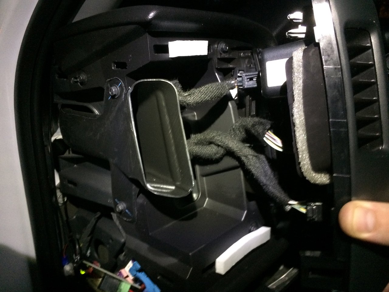

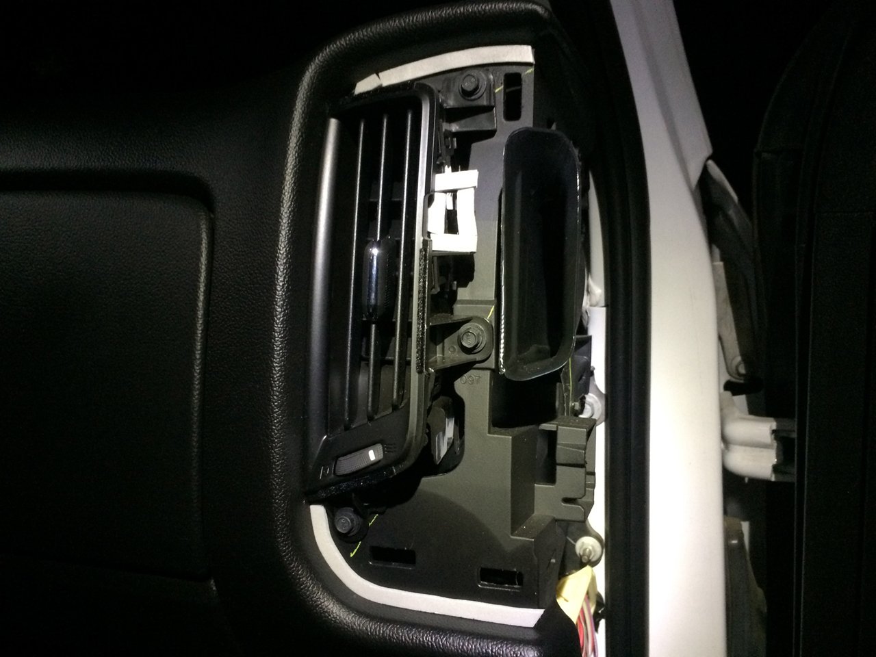

Several thin strips are used behind the passenger side vent assembly.
Two more strips are directly attached to the vent assembly prior to reinstalling the fuse box cover.

Great idea or can also use flocking tape.  GM recommends Kent Moore (you can buy sheets of it at the dealership) or you can get off-brand rolls like this:
https://www.amazon.com/J-V-Converting-FLOCK-1-BLK05833-Flocking/dp/B01B5FNRA8/ref=sr_1_3?ie=UTF8&qid=1531937181&sr=8-3&keywords=flock+tape
It works a little better since the adhesive is stronger and the tape itself is not as thick as weatherstripping.
