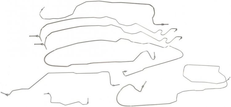

Do you by chance have $60 and about 30 spare minutes?
This link is for the ENTIRE brake line kit.
Just replace the line that is between the ABS pump and the caliper.
Then replace other lines when you have the spare time, or as needed.
Check it out:
 https://www.ebay.com/itm/2002-Suburban-Yukon-XL-Avalanche-Complete-Hydraulic-Brake-Line-Kit-Set-Lines-SS/401244228504?hash=item5d6c050b98%3Ag%3AdwwAAOSwEzxYVFsy&_sop=15&_sacat=0&_nkw=2002+brake+line+kit&_from=R40&rt=nc

Thanks! I was able to do what I had mentioned but was able to save the hose going to the split on the rear end and keep it installed. However, when I flared the old line it kept splitting (too fragile, i assume). So it obviously still leaked with the fittings. Plugging the rear line on the master cylinder will get me through the week until I can get to it. That's a genius idea, thank you. Full kit is on it's way.
