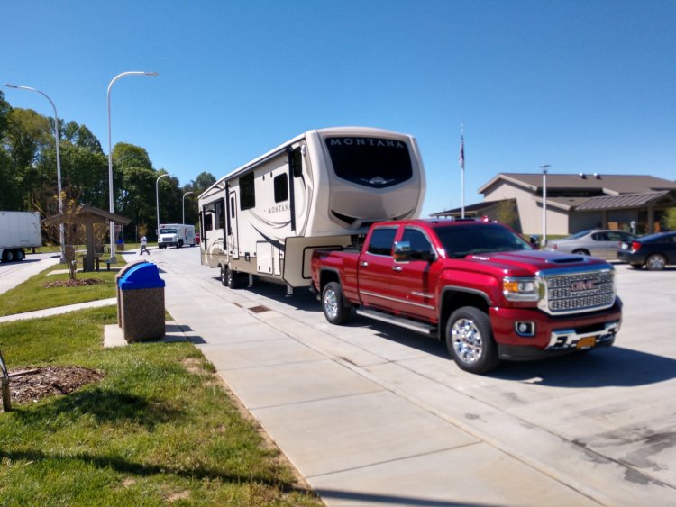

The pin weight on my rig (actual not advertised) is 3200#, truck sits fine without, but have added air bags for comfort and piece of mind.
My only real issue was with the tires, they were 250# over weight each, which made me a bit nervous. i upgraded to 285/60-20 and am now better than good
