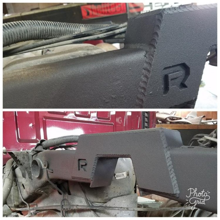

As the title says post em up.  I have a custom underbed notch im wanting to have installed but i have to psych myself up for it since this is the first brand new truck ive ever bought for myself
Frame is “notched” above rear axle assembly  (also sometimes called a c-notch) on lowered trucks (depending on how low you go) so the frame doesn’t bottom out on the rear axle.
There are some that bolt in, some that weld in, and some where the whole section of frame is raised up to make more room.

Low Rider with BiggerTires  or a mud truck ??  Paint the rest of the frame before the box goes back on . keep us updated.

And i have no idea why i would want a lowered mud truck
I have the notch. Just waiting to get it installed amd wanted to see others notches

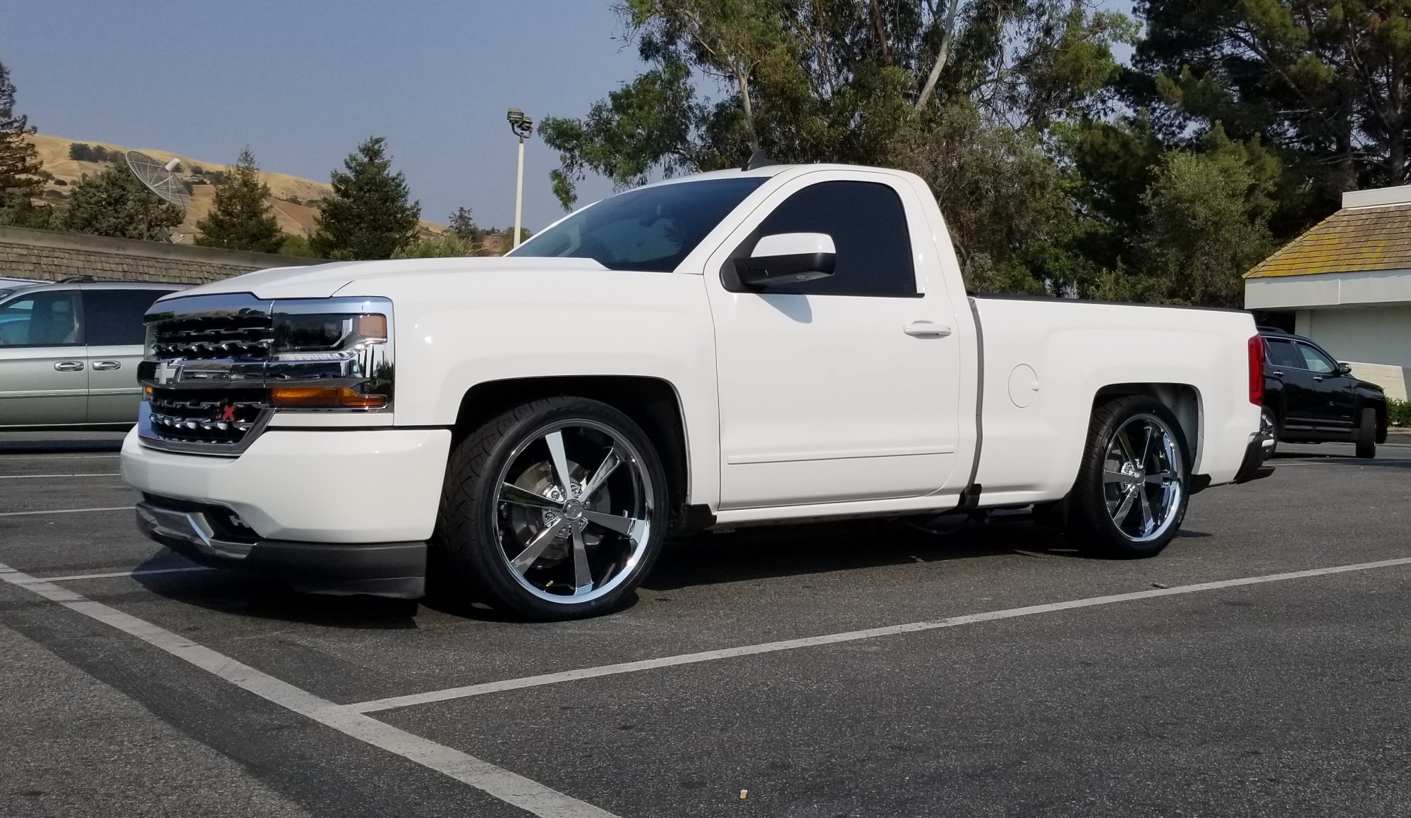

I just want lower. truck still sits to high. This is how it currently sits
