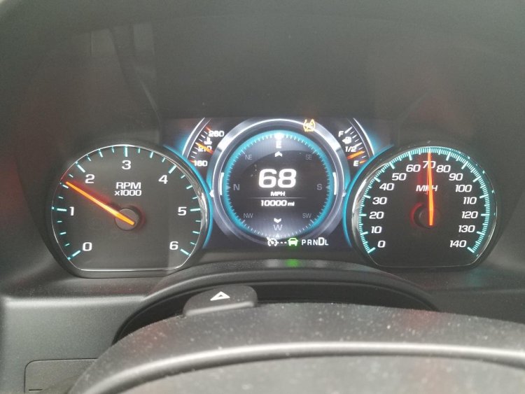

I have a Denali and like this gauge setup best.  You have to be in towhaul to see oil pressure and trans temp.
