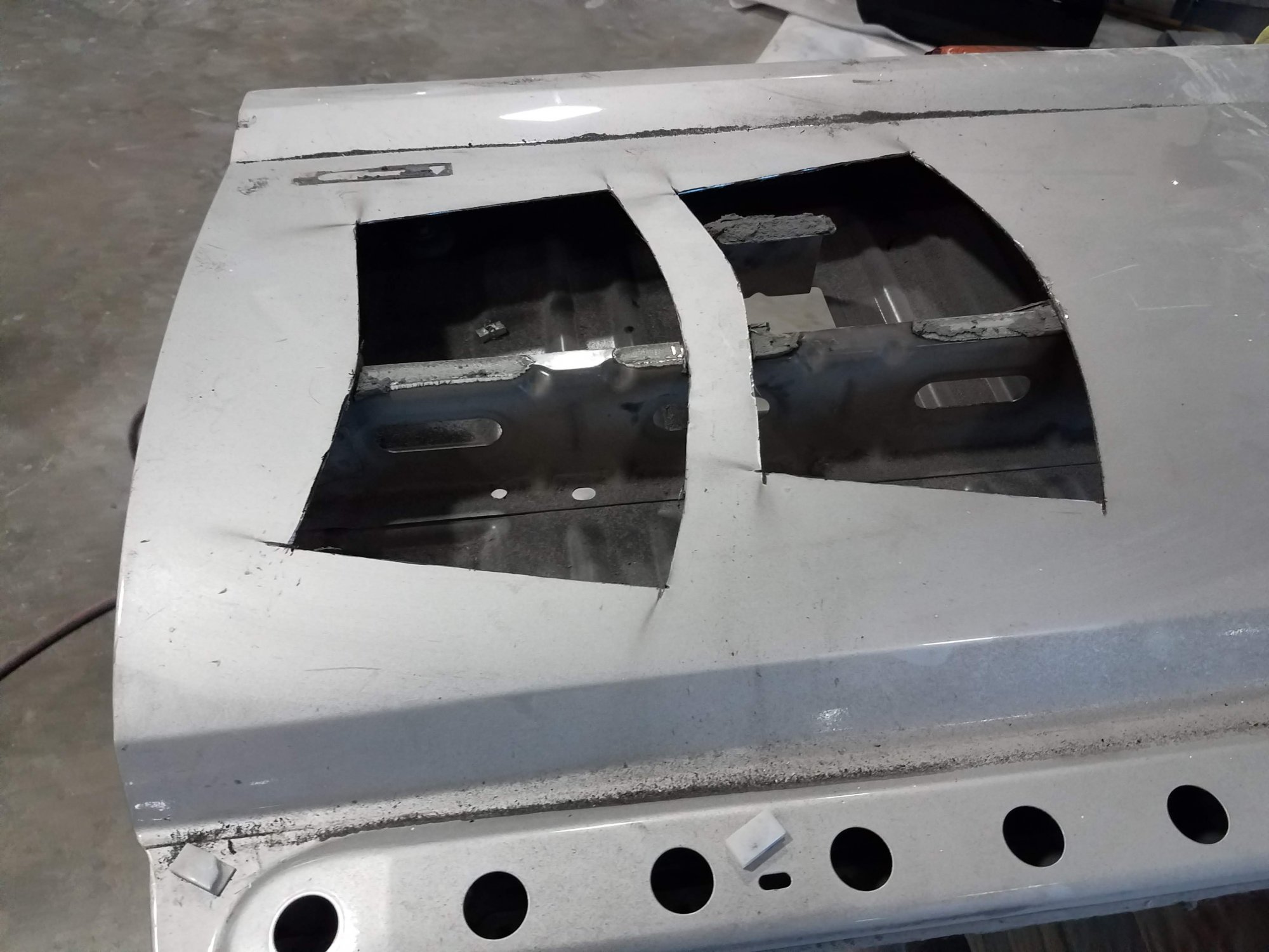

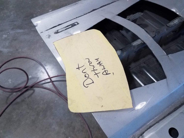

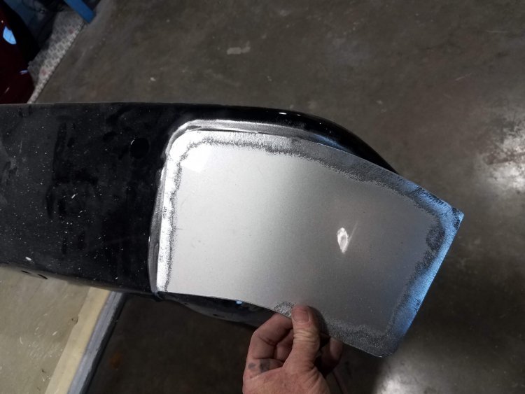

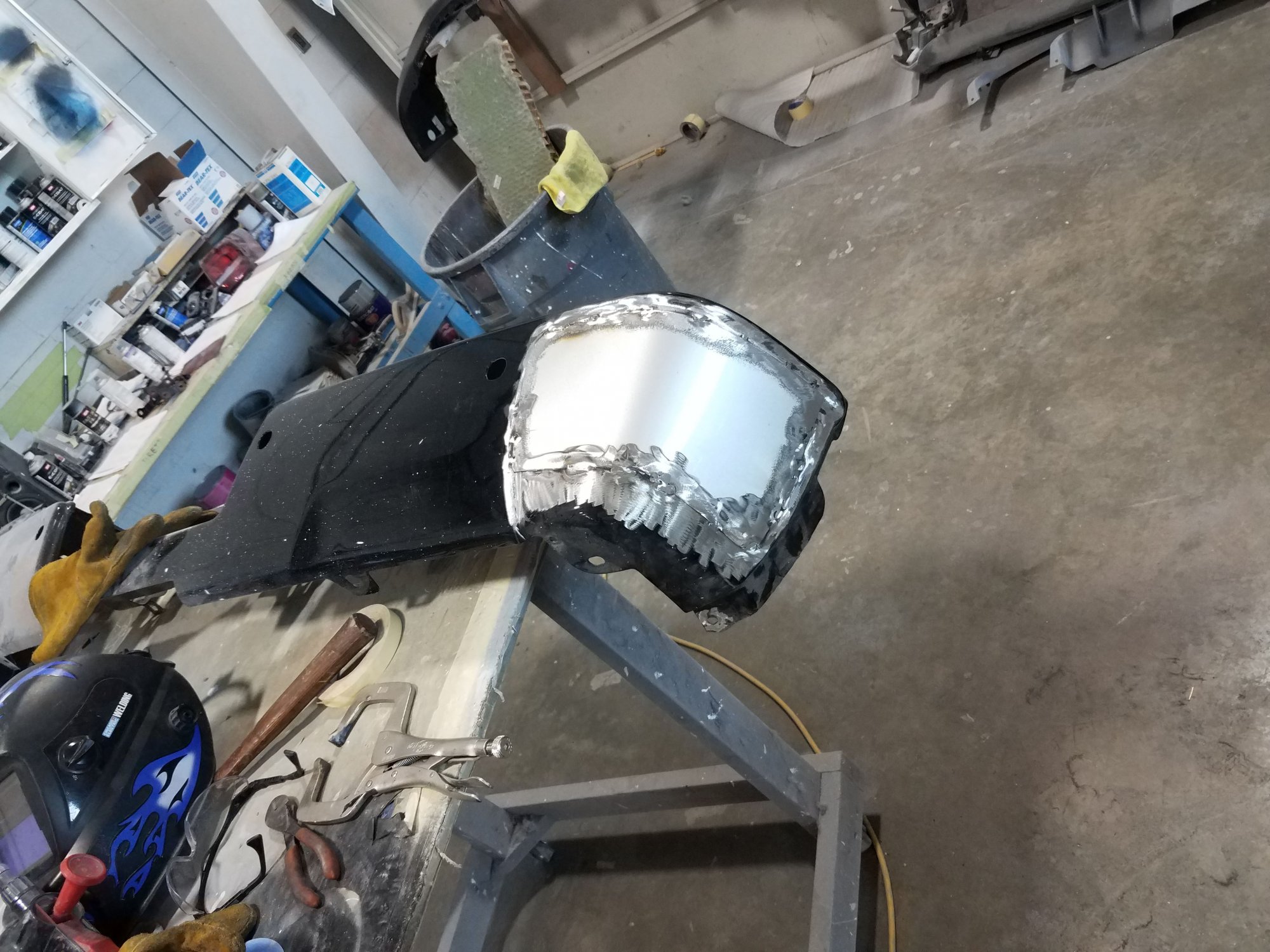

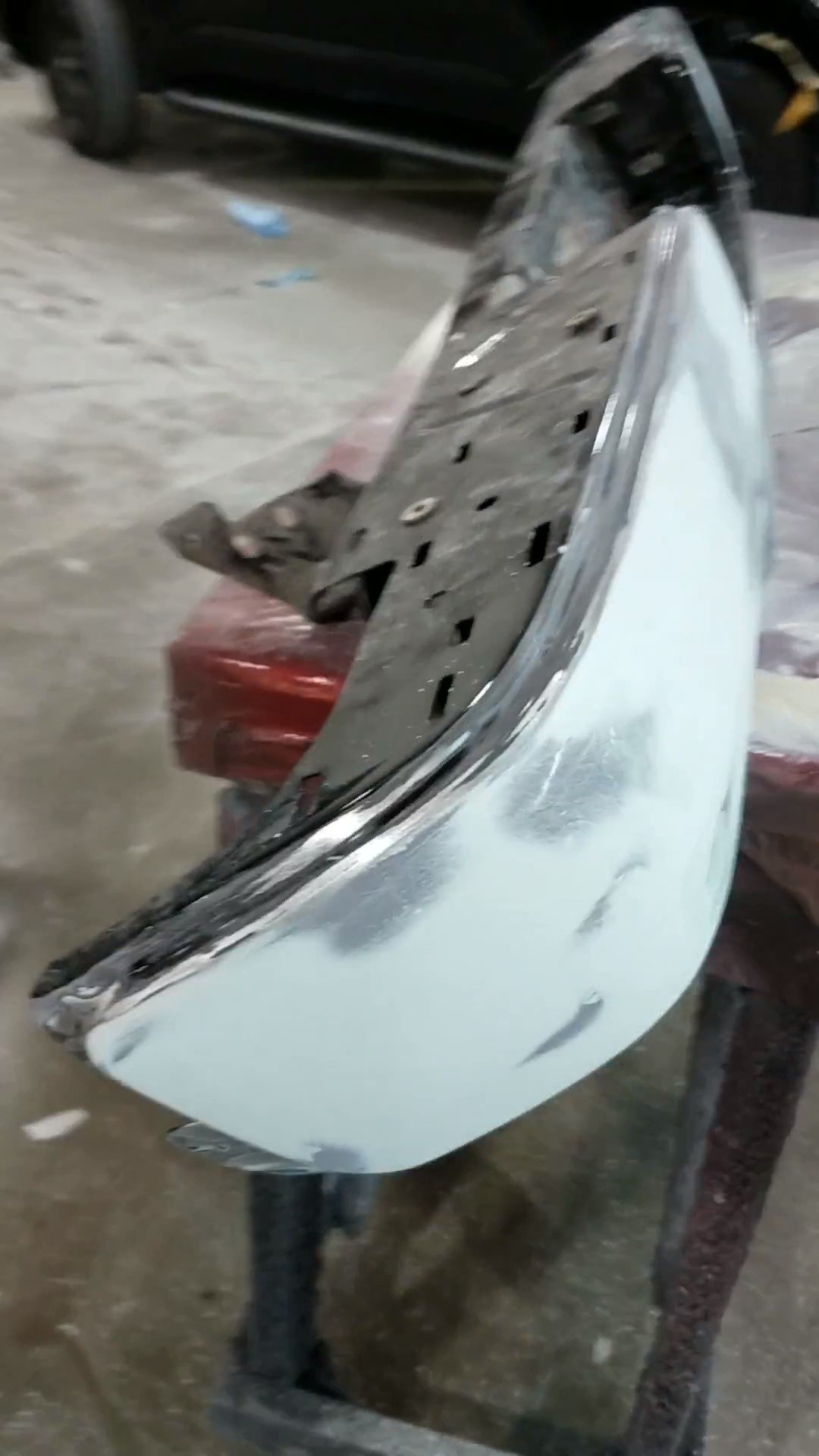

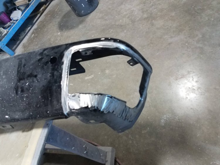

I wanted to go for a smooth look on the truck. so I shaved the step bumper .I cut some patches out of a junk tailgate.20180606_132719.thumb.jpg.804ffc7c5324a345fe0955e0f61d7f25.jpg20180606_132729.thumb.jpg.7435ed5c4ae6dc36ec433b104bc4e567.jpg20180606_132732.thumb.jpg.1143f1ce9a6c4809bb2a6c2e6e91235b.jpg20180606_132749.thumb.jpg.1776895eae39d52258ad119e9bfc4a73.jpg20180606_171327.thumb.jpg.46926640277bdef2388c51dbb5bafffd.jpg

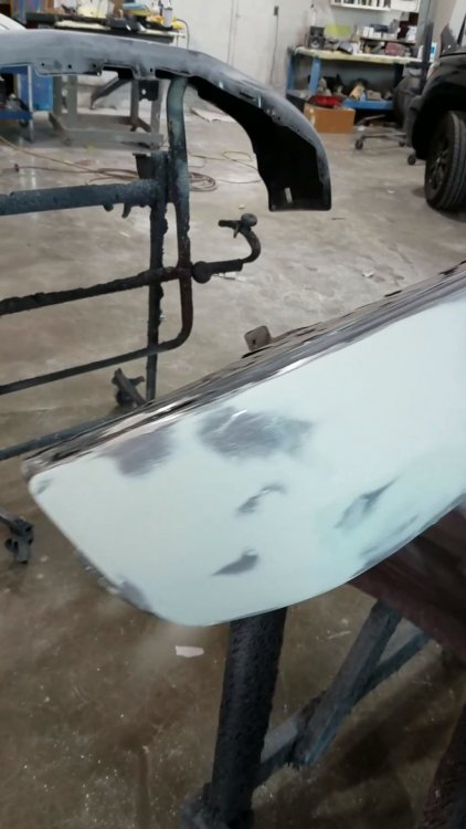

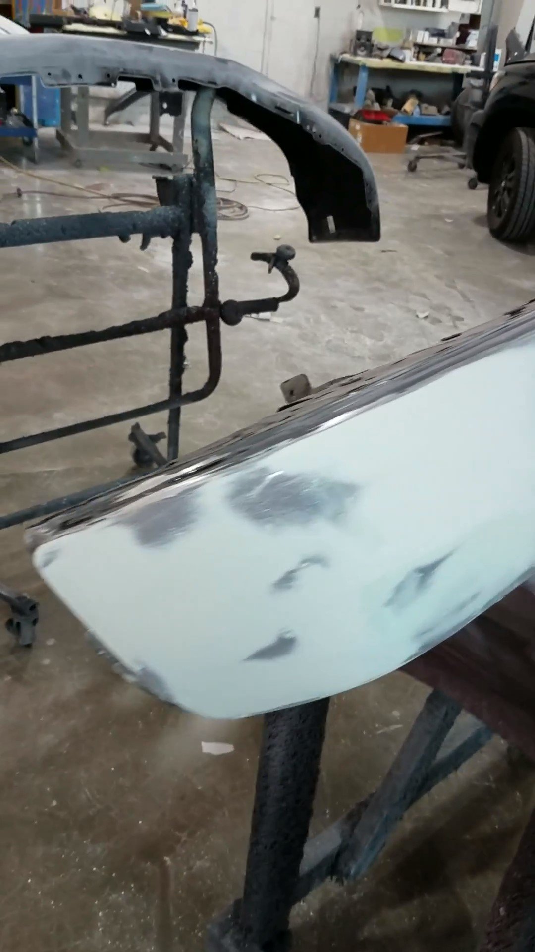

20180822_194730_Moment(6).thumb.jpg.cef5654007116e5b3ee9cd5ec9277ce5.jpgGlass and filled in, almost ready for primer,20180822_194730_Moment(4).thumb.jpg.dc12a2616779a1d4baf883d76406a73b.jpg
Where you able to recreate the groove in the bottom of the bumper?
Sent from my SM-G955U using Tapatalk
An easier way is just buying the 2014 all terrain bumper. But that work looks great!
I know it'll be easier but I've yet to find one. I've found aftermarket but I would like oem
Gmpartadirect has them. Thats where im ordering mine
Got a link for it?
Thanks but for the price I have a scrap bumper out back that I'm going to let a fab guy have fun with it lol
That's why I did mine cause I already had it. I will admit it was quite a job.
Sent from my SM-G930V using Tapatalk
Not sure which grove your referring too.
I did a few other mods ,like smoothing out the textured plastic trim, and mirrors. I upgraded the mirrors with help from PGAMBOA. Super great guy to work with.
